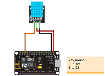

Step 2: Schematic Diagram
  • connect - to gnd
  • connect + to 3v3
  • connect S to D2

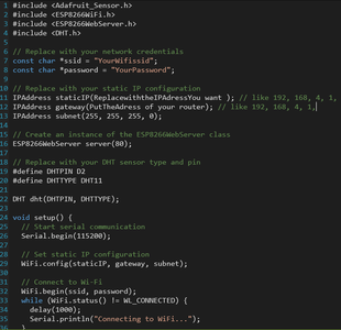

Step 3: Source Code
#include <Adafruit_Sensor.h>
#include <ESP8266WiFi.h>
#include <ESP8266WebServer.h>
#include <DHT.h>
// Replace with your network credentials
const char *ssid = "YourWifissid";
const char *password = "YourPassword";
// Replace with your static IP configuration
IPAddress staticIP(ReplacewiththeIPAdressYou want ); // like 192, 168, 4, 1,
IPAddress gateway(PutTheAdress of your router); // like 192, 168, 4, 1,
IPAddress subnet(255, 255, 255, 0);
// Create an instance of the ESP8266WebServer class
ESP8266WebServer server(80);
// Replace with your DHT sensor type and pin
#define DHTPIN D2
#define DHTTYPE DHT11
DHT dht(DHTPIN, DHTTYPE);

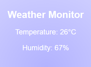

// Function to handle root URL
void handleRoot() {
float temperature = dht.readTemperature();
float humidity = dht.readHumidity();
// Determine background gradient based on temperature
String bgColor = getBackgroundGradient(temperature);
String html = "<html><head><title>Weather Monitor</title>";
html += "<style>body {margin: 0; overflow: hidden; transition: background 0.5s ease;}";
html += ".container {position: absolute; top: 50%; left: 50%; transform: translate(-50%, -50%);";
html += "text-align: center; color: #ffffff; font-family: 'Arial', sans-serif;}";
html += ".sensor-data {font-size: 24px; margin-top: 20px;}";
html += "</style>";
html += "<script>";
html += "function updateBackground() {";
html += "var posX = event.clientX / window.innerWidth;";
html += "var posY = event.clientY / window.innerHeight;";
html += "document.body.style.background = '" + bgColor + "';";
html += "document.body.style.backgroundImage = 'radial-gradient(circle at ' + posX * 100 + '% ' + posY * 100 + '%, rgba(0, 0, 255, 0.3), transparent)';}";
html += "document.addEventListener('mousemove', updateBackground);";
html += "setTimeout(function() { location.reload(); }, 60000);"; // Refresh every minute
html += "</script>";
html += "</head><body>";
html += "<div class='container'>";
html += "<h1>Weather Monitor</h1>";
html += "<div class='sensor-data'>";
html += "<p>Temperature: " + String(temperature) + " °C</p>";
html += "<p>Humidity: " + String(humidity) + " %</p>";
html += "</div>";
html += "</div>";
html += "</body></html>";
server.send(200, "text/html", html);

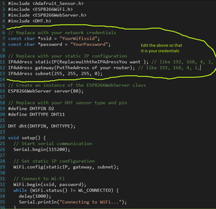

I have set it up to use a static IP
all you need to do is replace this part with your credentials and stuff
