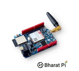

In this project, we are using Bharat Pi which has both ESP32 microcontroller and a SimCom A7672S 4G/LTE module. Bharat Pi is an IoT prototyping board for students, innovators, startups, and developers. A simplified board with an all-in-one compute, network and storage on a single board to build rapid prototypes.

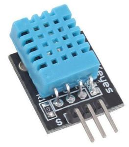

1. DHT11 Temperature and Humidity Sensor

In this section, we will see how to connect DHT 11 sensor with ESP32. The DHT 11 sensor will be connected with the ESP32 board with its 3 pins (GND, VCC, DATA).
Follow the schematic diagram for the ESP modules and connect them accordingly. Connect the ESP32 device with the DHT 11 sensor as shown in the schematic diagram above:
DHT 11 Sensor Pinout
VCC - Power Supply
DATA - GPIO
GND - GND
Wire the DHT 11 sensor to the ESP32 as shown in the following schematic diagram. We’re connecting the VCC pin to 3V/5V, and the DATA pin to GPIO 23, but you can use any other suitable pins, then GND to GND pin.
ESP32 Wiring With DHT 11 Sensor
DHT 11 Sensor - ESP32
VCC - 3V / 5V
DATA - GPIO 23
GND - GND

Here’s the pinout of the DHT11 Sensor :
VCC
DATA
GND
