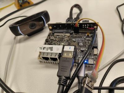

Things used in this project:
  • Mixtile Blade 3 board
  • An HDMI cable
  • A monitor
  • Type C USB hub
  • Some pictures

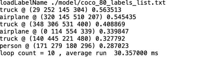

Step 2: Run the Demo
Run the demo
cd install/rknn_yolov5_demo_Linux
./rknn_yolov5_demo ./model/RK3588/yolov5s-640-640.rknn ./model/bus.jpg
Output results:
img width = 640, img height = 640
Loading mode...
sdk version: 1.4.0 (a10f100eb@2022-09-09T09:07:14) driver version: 0.7.2
model input num: 1, output num: 3
index=0, name=images, n_dims=4, dims=[1, 640, 640, 3], n_elems=1228800, size=1228800, fmt=NHWC, type=INT8, qnt_type=AFFINE, zp=-128, scale=0.003922
index=0, name=output, n_dims=5, dims=[1, 3, 85, 80], n_elems=1632000, size=1632000, fmt=UNDEFINED, type=INT8, qnt_type=AFFINE, zp=77, scale=0.080445
index=1, name=371, n_dims=5, dims=[1, 3, 85, 40], n_elems=408000, size=408000, fmt=UNDEFINED, type=INT8, qnt_type=AFFINE, zp=56, scale=0.080794
index=2, name=390, n_dims=5, dims=[1, 3, 85, 20], n_elems=102000, size=102000, fmt=UNDEFINED, type=INT8, qnt_type=AFFINE, zp=69, scale=0.081305
model is NHWC input fmt
model input height=640, width=640, channel=3
once run use 40.653000 ms
loadLabelName ./model/coco_80_labels_list.txt
person @ (114 235 212 527) 0.819099
person @ (210 242 284 509) 0.814970
person @ (479 235 561 520) 0.790311
bus @ (99 141 557 445) 0.693320
person @ (78 338 122 520) 0.404960
loop count = 10 , average run 34.209300 ms

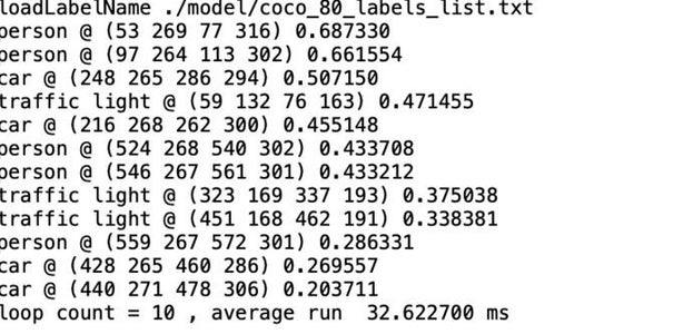

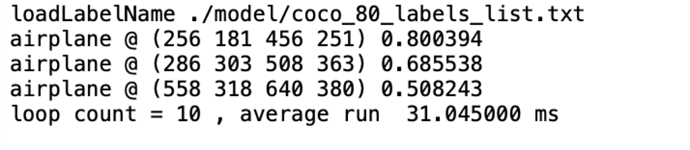

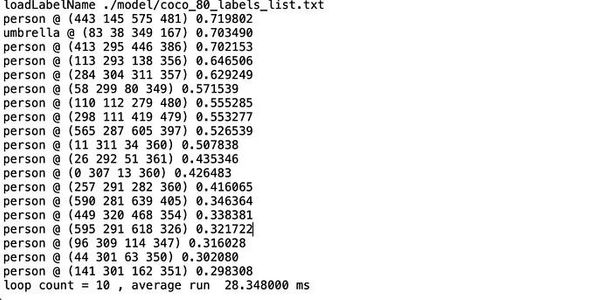

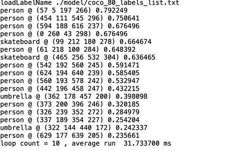

Step 3: Get the Benchmark of These Test Images
Get the benchmark of these test images
wget --load-cookies /tmp/cookies.txt "https://docs.google.com/uc?export=download&confirm=$(wget --quiet --save-cookies /tmp/cookies.txt --keep-session-cookies --no-check-certificate 'https://docs.google.com/uc?export=download&id=1nZzd4jOM6XyVmne_BtmrmHGHGfrsBstP' -O- | sed -rn 's/.*confirm=([0-9A-Za-z_]+).*/ \n/p')&id=1nZzd4jOM6XyVmne_BtmrmHGHGfrsBstP" -O coco_calib.zip && rm -rf /tmp/cookies.txt
unzip coco_calib.zip

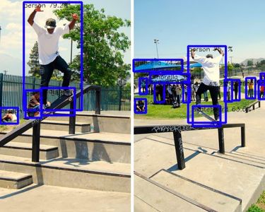

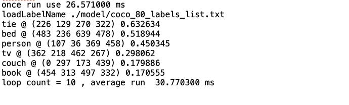

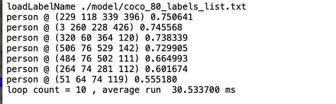

Without further ado, let’s see how many items we can identify in the photos, along with the average image processing time:
Step 4: Show Benchmark of Test Images
