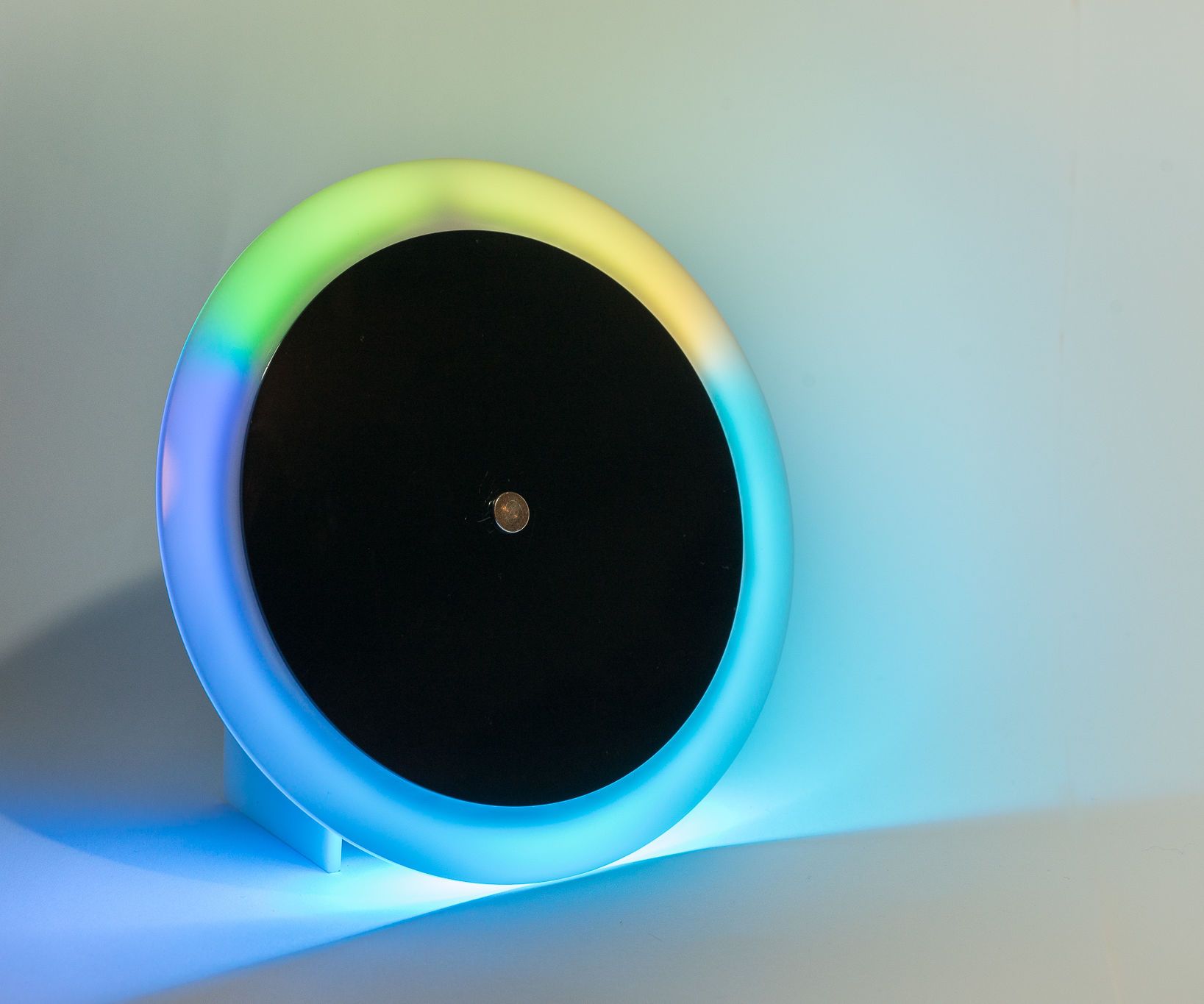

Welcome to The Light Clock, part art-piece, part timepiece, it's a modern take on the classic analogue clock. Where a traditional clock face uses hands to tell the time, The Light Clock turns your whole wall into a timepiece through a striking display of coloured light. You have the power to choose from millions of colours, allowing you to perfectly complement your existing décor, or simply to match your mood.

To create the hour and minute hands, The Light Clock projects light in two different colours. At first glance this might seem complicated, but very quickly you’ll notice that you can read it with ease.
In this example we’ve used yellow light as the hour hand, and blue light as the minute hand. Comparing each Light Clock with the corresponding traditional displays, you can see how each colour comes to an edge where a hand would normally be. Click for an animated example.
