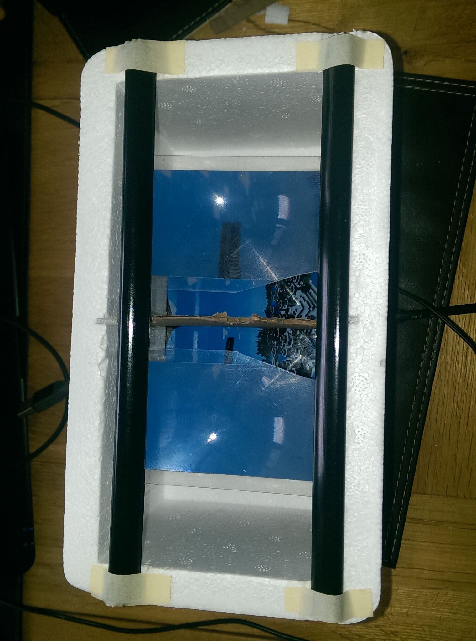

- I wrote down the dimensions of the LCD screen, which was ~16.3cm in width and ~11.2cm in height. I wanted the LCD to fit nice and snug, so I started with a back panel that was just a couple centimeters larger than the actual screen.
- The focus distance of the lens I used is roughly 5cm. With this in mind, I cut out side panels of 5cm.
- In order to finish up the "box" holding the LCD, I had to make a front panel with eye holes and a bridge for the nose. I own a pair of round glasses, which I measured and placed in the center of the front panel and traced out. I made some adjustments so that it could hold the lenses I was using, and then started on a design that forms to the head.
- The HMD needed to be able to block out most of the surrounding lights in order to create a more immersive experience, so I measured about 5cm in order to blind the peripheral vision and added that to the side of the eye panel. I then bent a wire on the surface of my forehead, and cut that part out of both the top panel and the bottom panels
- I then taped all adjacent pieces together, resulting in a total of 7 pieces—the back panel, the two bottom panels, the two side panels, the top panel, and the front eye panel
With the design ready, we can now move on to cutting out the pieces!

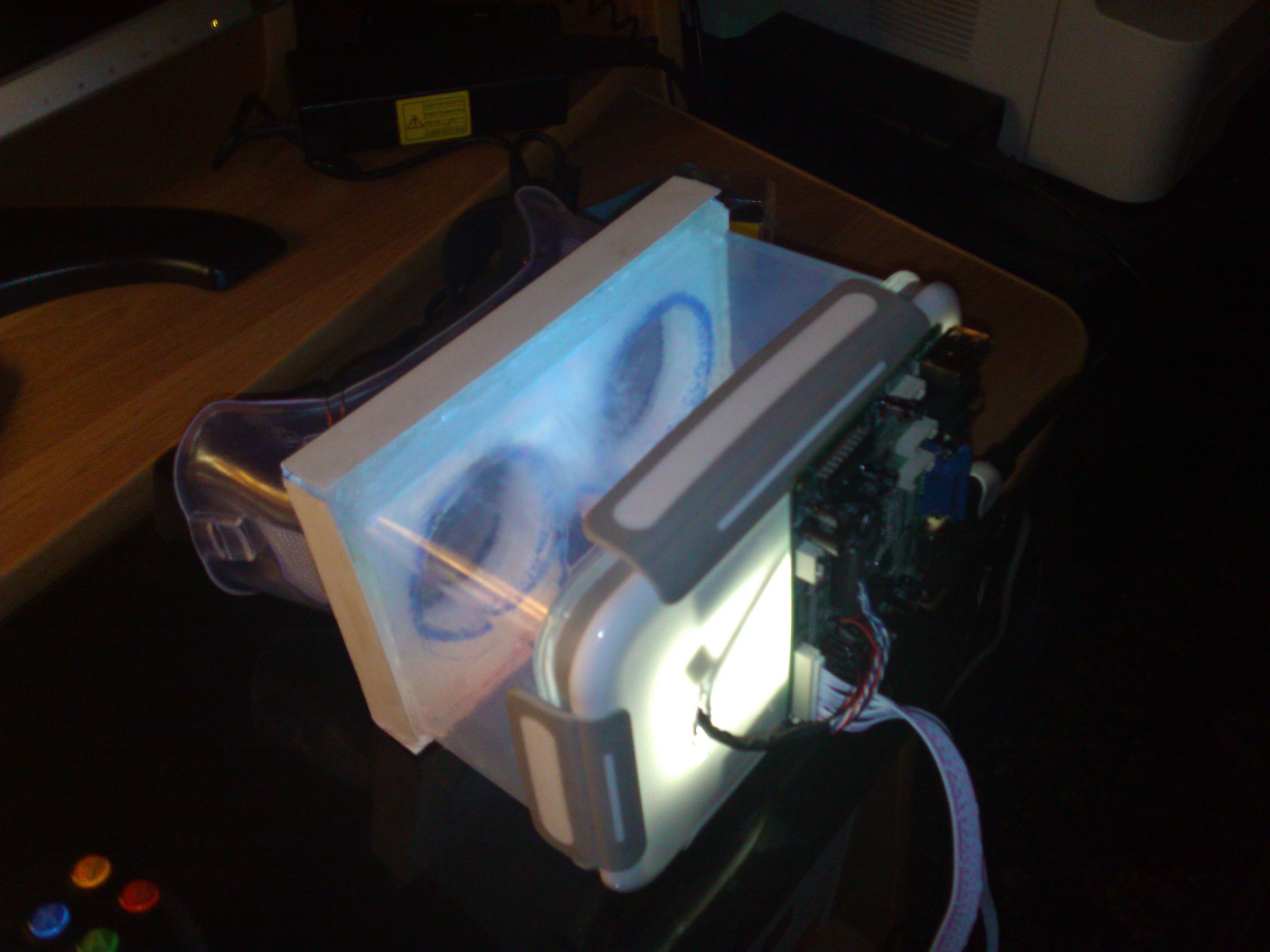

This step is fairly easy, just hot-glue all the pieces together.
- Start with the back panel. Hot glue the top and side panels to the back panel, and then slide in the eye panel to ensure it fits. If not, trim off a couple of millimeters off until it fits snugly.
- Once you've fitted the eye panel, remove the eye panel and lay down the LCD screen. Hot glue the back of the screen in each of the four corners and place it onto the back panel.
- Wrap the controller board around the back and hot glue it to the back. Thread the cable between the unused parts of the board (the VGA and Video port).
- Hot glue the controller board's switch onto the unit. I chose to place it on the left side.
- Place the lenses inside the eye holes of the eye panel. Make sure they're level with the panel, and then hot glue them in place.

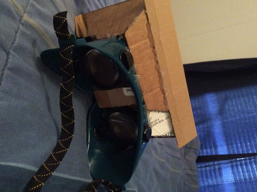

- Remove the visor from the ski goggles if you haven't already. Place the bridge of the ski goggles in-between the two eye holes, and hot glue the goggles into place. Use plenty of hot glue here; you don't want your Nova to fall off your face and possibly break.
- Load up a screenshot of an Oculus Rift demo and place the unit on its back. Slide the eye panel inside the unit and adjust it until it is focused properly, then hot glue it in place.
