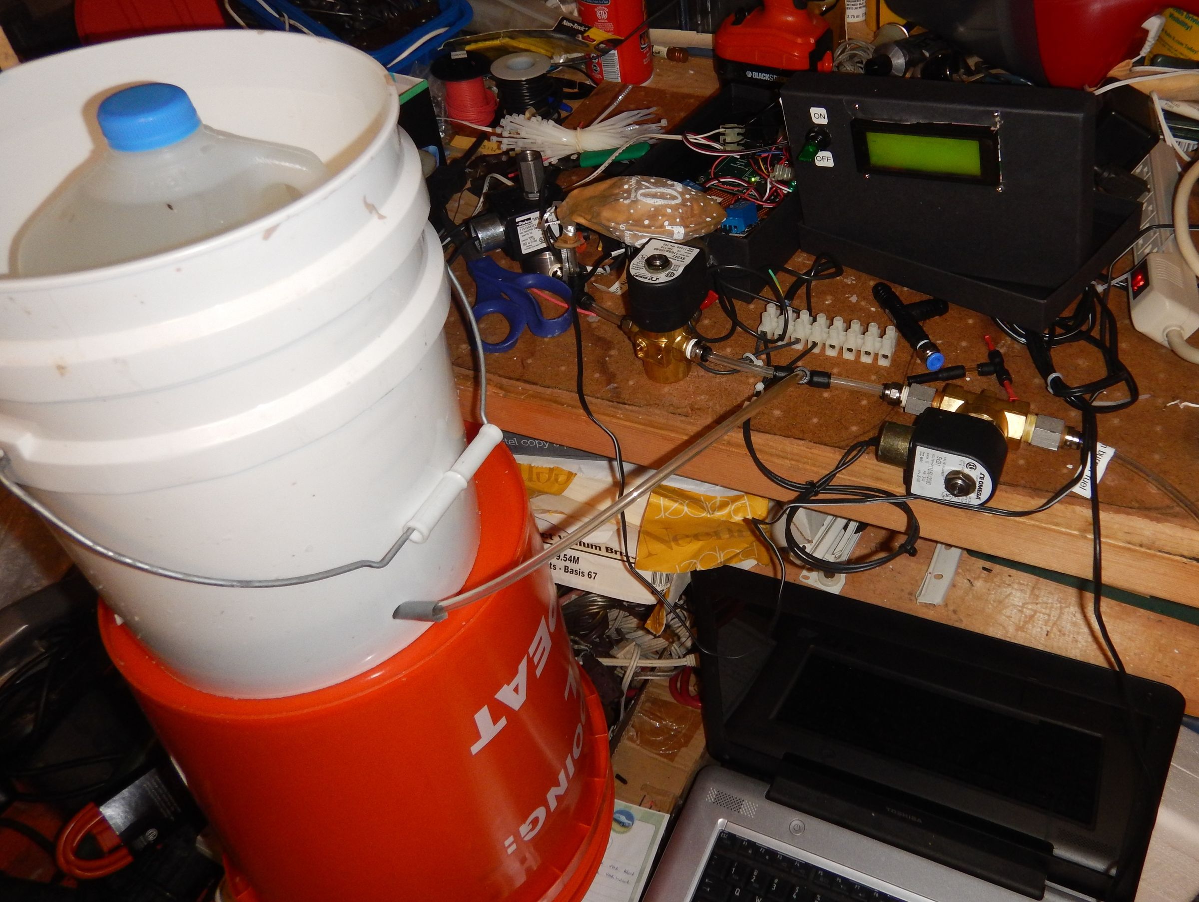

It basically consists of the bellows unit, which is made of wood, valves and piping, a PLC controller, some wires and switches and a power supply unit.
The whole unit is mounted on a piece of 1/2 inch thick plywood that is18 inches by 21 inches.

Step 3: Making the Bellows
The Pandemic Ventilator Project
The bellows unit has a hinged section of quarter inch plywood that is 10 1/2 inches by 12 1/2 inches.
There is a one and a 1 1/2 and a 1/2 inch by 9 inch sensor pole attached beside the bellows that is used to position the magnetic switches. These are magnetically activated reed switches that are usually used for security systems. The sensor pole should be angled at the bottom so that the top leans back about 1 1/2 inches from the bottom.
The bellows hinge is constructed of 4 pieces of 1 1/2 by 7 inch 5/8 inch plywood pieces and a 1 1/2 by 1 1/2 inch by 17 inch piece of wood, two 3 inch hinges and a 2 inch by 12 1/2 reinforcement.
The bellows is made by screwing down the bottom 2 plywood pieces to the backing board.
Arrange the other 2 plywood pieces directly over the first two, cover with the 17 inch piece of wood and and clamp together.
Drill holes centered 2 and 3/4 inches from each end to accept 1/4 inch carriage bolts inserted from the bottom.
Un-clamp and remove the top 17 inch piece of wood.
Insert carriage bolts from the bottom to line up the middle layer plywood pieces and clamp again.
Screw hinges to middle layer plywood. Ensure the screws do not protrude through the plywood to the bottom layer.
Screw the other side of the hinges to the bellows lid between the lid and the reinforcing strip.
The bag is clamped between the two plywood sections during operation using the nuts and washers on the carriage bolts.
The magnet is attached to the end of the bellows near the sensor pole, and the sensors are attached to the sensor pole. I just used duct tape to attach them so that they can be easily adjusted during the testing phase.
Step 4: Adding the Bag
To make the bag for the bellows, I used a large size Ziplock freezer bag.
Cut off the ziplock part.
Inert 1/2 inch plastic tubing into the center and use Tuck tape to seal and reinforce the edges.
The tubing should stick out of the bag far enough to be able to be slipped over the end of the 1/4 inch nipple section of piping.
The taped seam of the bellows bag should be in on the bottom plywood section.
Install the hinged cover and then the top 17 inch section.
Clamp together with the 4inch long 1/4 inch carriage bolts, two nuts and 2 washers.

Step 6: Ventilator Running
Here is a video of the Pandemic Ventilator running.
I am using an earlier bellows design for my patient simulator. If you wish to test run your own unit you can build a second bellows unit for a lung simulator. No not try it on yourself or anyone else. The patient airline that runs to the simulator is 1/2 inch ID plastic tubing that has been Y ed together at the patient end. You need a regulated compressed air source to run it. It is best if you can get the pressure down to about 10 psi. The higher the inlet pressure, the greater the chance that the bellows will inflate too fast for the upper level switch to detect. If this happens, you blow up your bellows bag. When I initially test ran my unit, I used switches to simulate the bellows mag switches to confirm that the program would function as intended.
I put some wrenches for weights on the bellows and simulator. The weight on the bellows provides the pressure to inflate the patients lungs. The weight on the patient simulator bellows simulated the lung expelling the air. The bellows weight has to be greater than the simulator weight to make it work.
