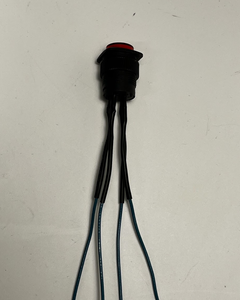

  3. Cut 32 pieces, 4 for each illuminated button, of approximately 4 in in length of solid core wire
  4. Strip about 1 in from one side of each piece of wire and about 1 cm from the other side of each wire
  5. Loop the 1 in side of the wire through one of the contacts on the back of one of the illuminated buttons, as shown in the image above
  6. Repeat the previous steps with all the contacts on all 8 of the illuminated buttons
  7. Use a soldering iron to solder the looped solid core wire to the contact it is attached to
  8. Repeat this with all of the attached wires
  9. Heat shrink one of the heat shrink tubes over each contact and its attached wire, as shown above
  10. NOTE: the contact marked + is the positive side of the LED and the contact marked - is the negative side of the LED. The other two contacts will be the button wires
