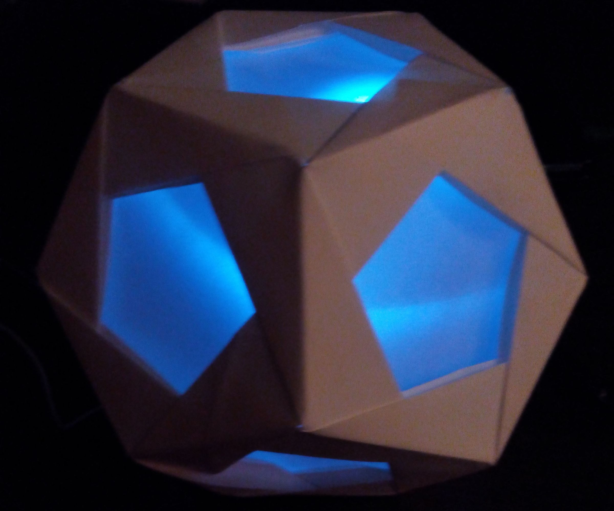

I have used this circuit in another project I made if you would like to see it : https://www.instructables.com/id/Twinkling-Dodecahe...
