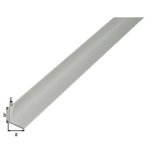

  • 10x10mm aluminum L profile

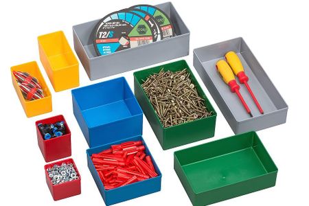

These organizers are really modular, so you can buy one full of smaller inserts, bigger inserts or with mixed ones. Or you can even buy empty organizers and separated inserts, to optimize your contents.
With this brand, for example, you can find 4 different sizes of inserts (with different colors):
  • 54x54mm - Red
  • 54x108mm - Yellow
  • 108x108mm - Blue
  • 108x162mm - Green
All the inserts has the same height, 45mm.
In addition you also have an irregular shaped insert in the front side of the organizer (the grey one), useful for spares or temporary storage, in my opinion.
I think this 4 sizes is enough for a lot of parts, but in some cases you could store very small parts, so even the smaller insert is too big. In these cases I optimized the space with custom made "sub-separators".
You can also need to store parts with uncompatible form factor. An example are through hole resistors: tiny, but with long leads, so you can't easily put them in the smaller insert, but if you use the yellow one you waste a lot of space and you need a lot of boxes to store a reasonable set of values! So, you can pick a bigger insert and arrange it with custom dividers. Let's see later how we can do this...

Then, I cut the guides from a 10x10mm aluminum L-shaped profile, each one with 2 holes (3.5mm diameter) to fit the screws.
I measure and draw the position for the guides (32mm from the base).
