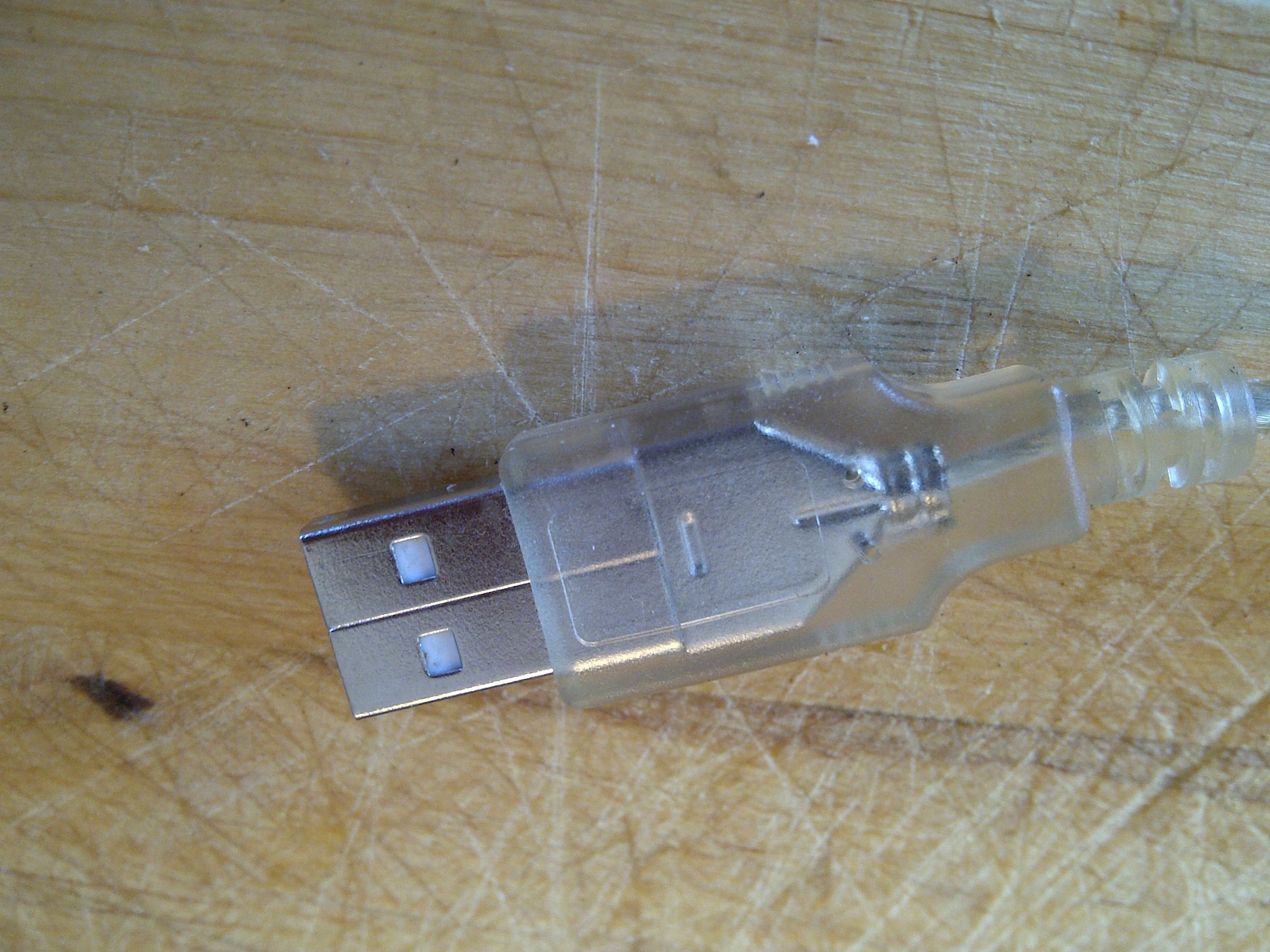

The bad thing about these (and let's face it, for $1 there has to be a negative) is that the cord sucks. Out of the box, this thing makes my phone flash on and off and frankly has me afraid that something will be damaged. So, first thing was to grab a couple of old USB "tails" (cords removed from defunct devices, like card readers, cordless keyboard base units, etc) and graft them in to replace the original cables. I soldered them in (thankfully, the original cables use standard color coding) and taped them up. Ugly, yes, but it's all on the inside.

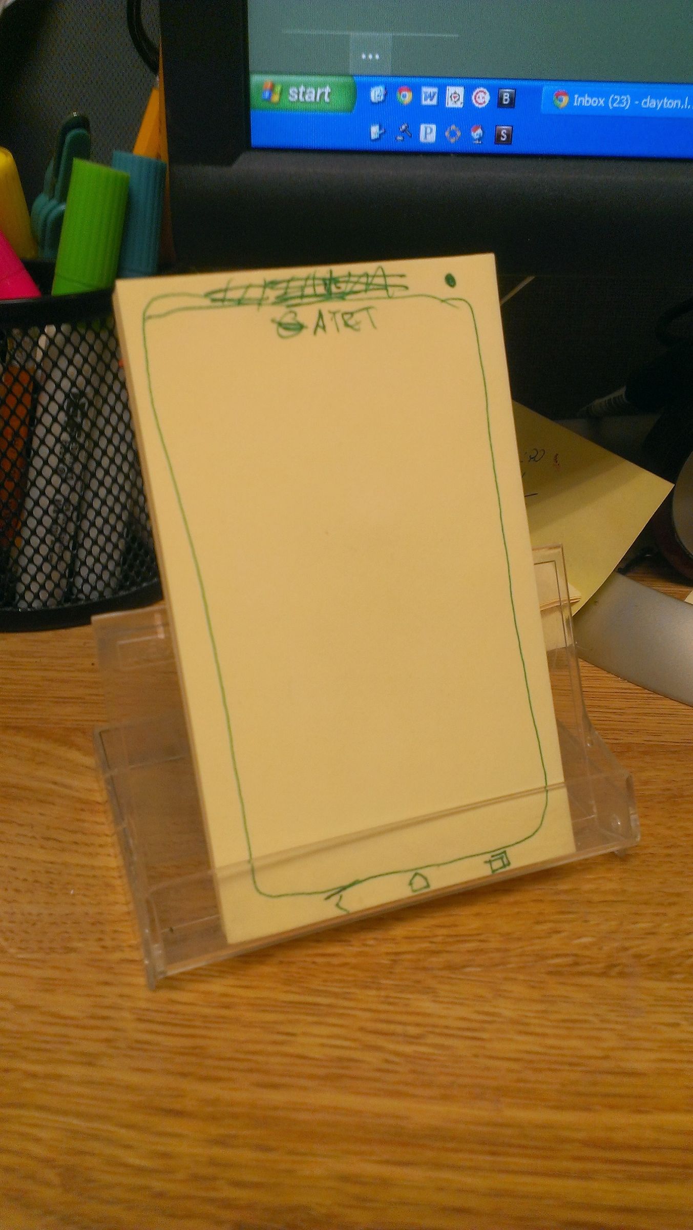

The phone (AT&T One X) was a little more complicated. First, the plug had to be turned around. No problem, just pull it out from the bottom, turn it around, and put it back in. That's okay, but the phone is then way off center and hangs off the right end. So I used a tiny drill bit and X-Acto knife to create a new hole for the plug. The plug is glued in and then I cut/broke off the little post that held the plug tight in the original position (on the right in the second picture) and used a spot of glue to put it right under the plug in the new position. It wedges nicely between the plug and the bottom of the stand. Next time, I think I'll just use a blob of PC-7 or similar epoxy, but I just didn't have any around this time. Finally, I folded up a sticky note to bring the back support forward to match the angle of the phone. I'll replace that with something nicer, like maybe a piece of foam tape.
