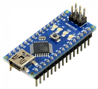

Step 2: Conection Diagram
The schematic shows the detailed connection of each of the sensors with the arduino nano, as well as the buzzer.
The battery is connected to a switch to limit the power flow and ideally supply the battery.
Specific conecctions:
VCC: Connect to the 5V pin of the Arduino Nano.
GND: Connect to the ground pin (GND) of the Arduino.
SDA and SCL: Connect to the I2C data pins of the Arduino (A4 and A5, respectively).
Buzzer:
Positive: Connect to a digital pin of the Arduino, such as pin 7.
Negative: Connect to a ground pin (GND) of the Arduino.
Switch:
One end connects to the battery and the other to the Arduino's VIN.

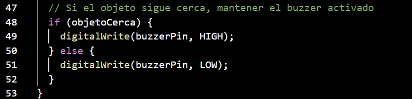

Step 3: Programming
A code is made in Arduino IDE for the programming of the sensors.
Use the VL53L0X library to initialize and read distance measurements from the sensor you need know the sensor can measure distances from 30 mm to 2 m.
Buzzer:
Configures the buzzer pin as an output.
Turns the buzzer on (by specifying HIGH on the pin) when the distance measured by the VL53L0X sensor falls below a specified threshold and the switch is on.
It turns the buzzer off (by specifying LOW on the pin) when the distance is greater than the threshold or the switch is off.
Test the code with the Arduino Nano.

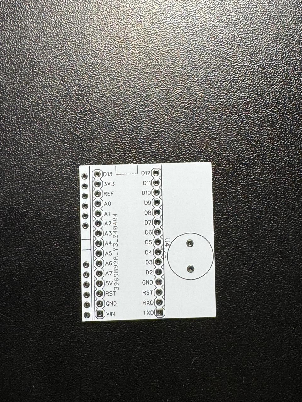

Step 4: Assembly
With a phenolic copper plate the Arduino Nano is placed to locate the connections that will have with the sensors before soldering with tin.
With the connections established we proceed to cut the phenolic plate to reduce its dimensions and to fit perfectly with the printed sketch.
Once this step is done, start soldering the wires with the respective pins of the arduino for the connection with the sensors.
