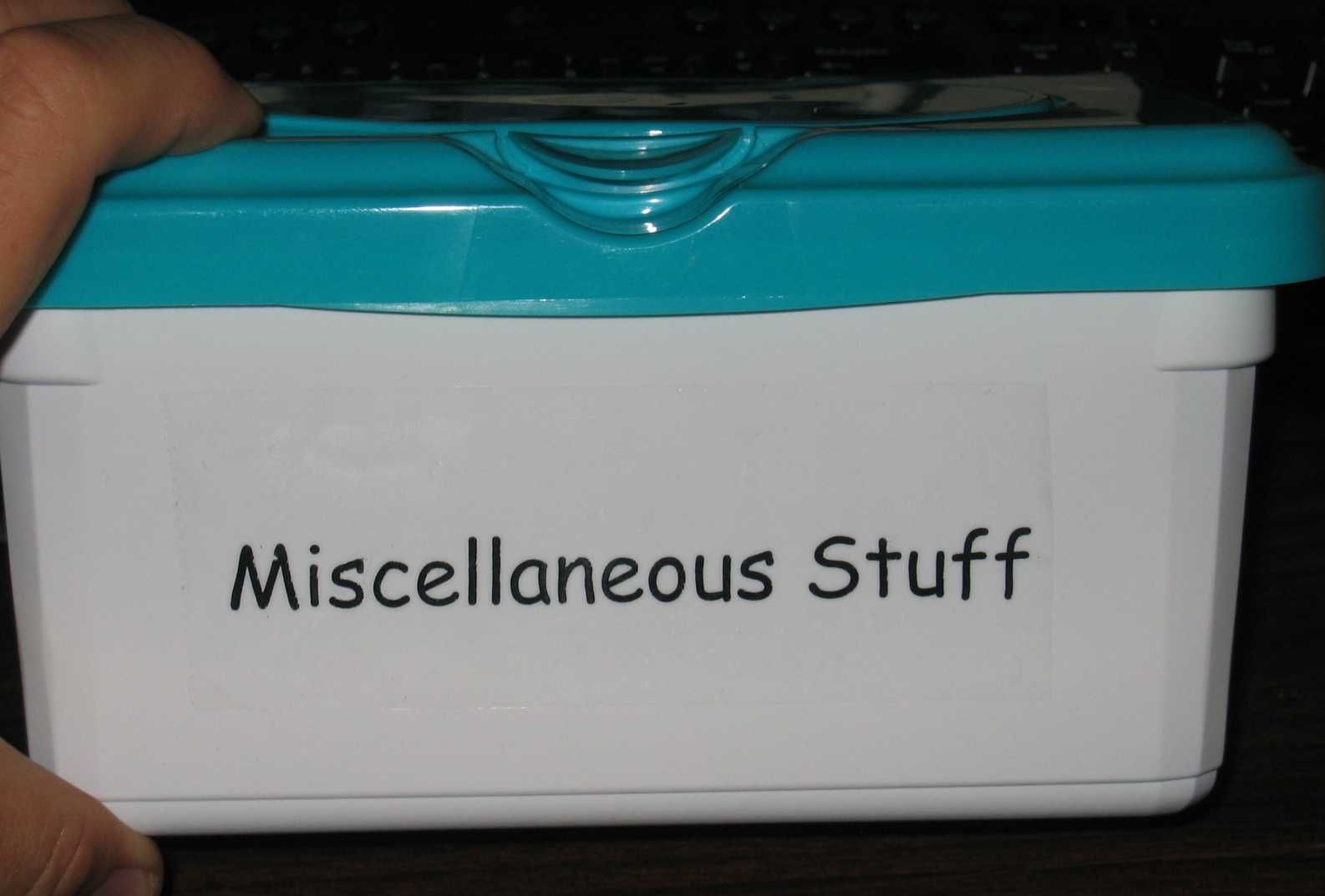

For most of the parts I was looking for stuff I had sitting around. This is the parts list for what I ended up with.
(2) - 3/16" plywood - 5" x 7" for the top and bottom
(2) - 3/4" x 3/4" x 3' pine - 5" and (2) 7" for the frame
(2) - 1/4" dowel - 2-1/2" to support the keys
(1) - 3/8" aluminum rod - 4" to hold down the keys
(1) - 3 1/2" nail - cut to 3-1/4"
5/8" x 18 brads - optional
(2) - #6-32 x 1/4" T-nuts
(2) - #6-32 x 1" round head bolts
street sweeper bristles - enough to make 9 keys about 2-1/2" - 3-1/4" each.
I had to buy the T-nuts and bolts but the rest I was able to scrounge. The "keys" were made out of street sweeper bristles. They're easy to find if you get out and walk much, just keep an eye on the street.
