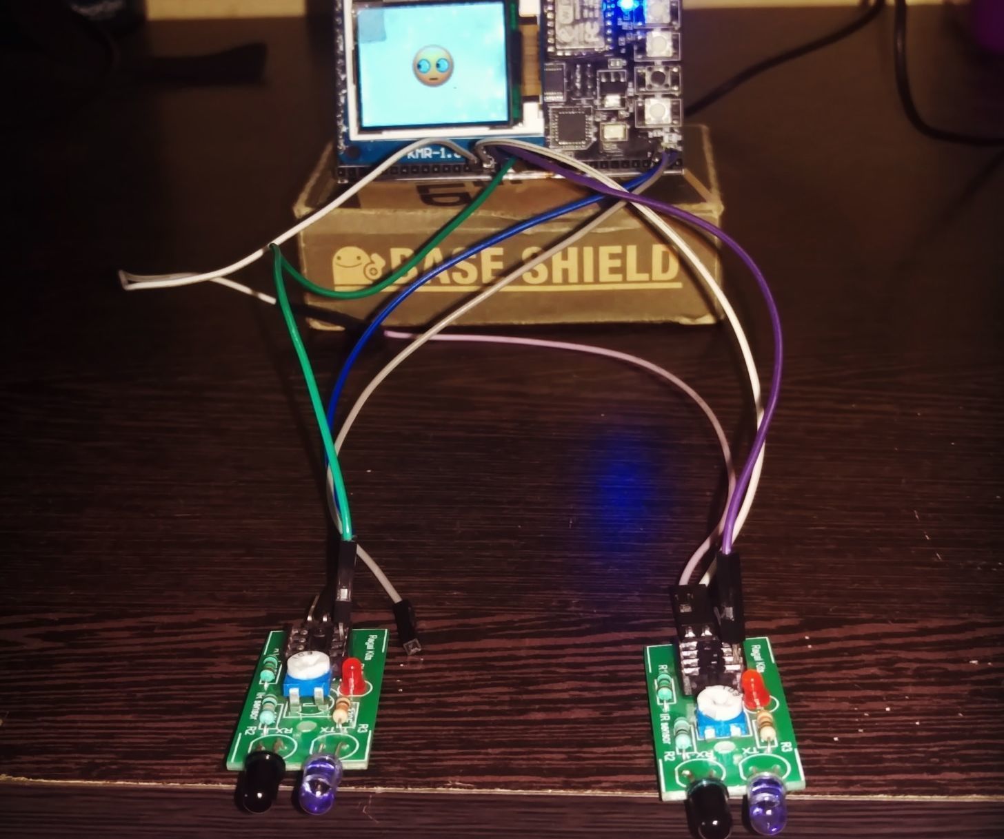

In this instructable, we are going to make an nfc based smart employee in/out management system which keeps track of your employees working hours.
We get the current-time information using the NTP (Network Time Protocol) with the Wi-Fi module (Esp8266) of Slabs-32 and send it to Atmega328p on the I2C bus.
The Atmega328p then uses this time information to make a record, whenever an employee swipes it's NFC tag to go outside or come inside of the office. It then calculates the time difference between the IN time and OUT time and displays it on the TFT screen of SLabs-32.
We can also send the information about the time spent by the employee in the office to the google spreadsheet using onboard Esp8266 but not in this instructable. This method has already been done by Stephen Borsay (link), I have integrated the same using this application.

Step 2: Hardware Connections
The Nfc module can be interfaced with our development board on I2C, SPI or High-speed UART bus, it's up to us to decide. In this project, we will be using SPI mode.
Make the connections as per the circuit diagram given above and you should have no problems.
  • Vcc → 3.3 V
  • GND → GND
  • SCK → PD4
  • MISO → PD3
  • MOSI → PD2
  • SS → PD7
