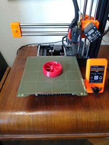

This miniature flying disc is a great way to learn about 3d printing and flight. With less than two hours of printing and minimal setup you can take to the skies with this twister.
- 3d printer
- 3d printer filament (PETG is preferable but not necessary)
- 20,000-30,000rpm rotary tool (we used a Dremel)
- screw-head for the rotary tool
- adjustable wrench
Step 1: Print
Print the twister and the tool-head with 20-30% infill.
Step 2: Assemble the Tool-head
Use the rotary tool and an adjustable wrench to screw the screw-bit into the tool head.
Step 3: Let It Rip!
Crank you rotary tool to max rpm and watch your spinner take off like a rocket! CAUTION: be aware of your surroundings when launching the spinner.
