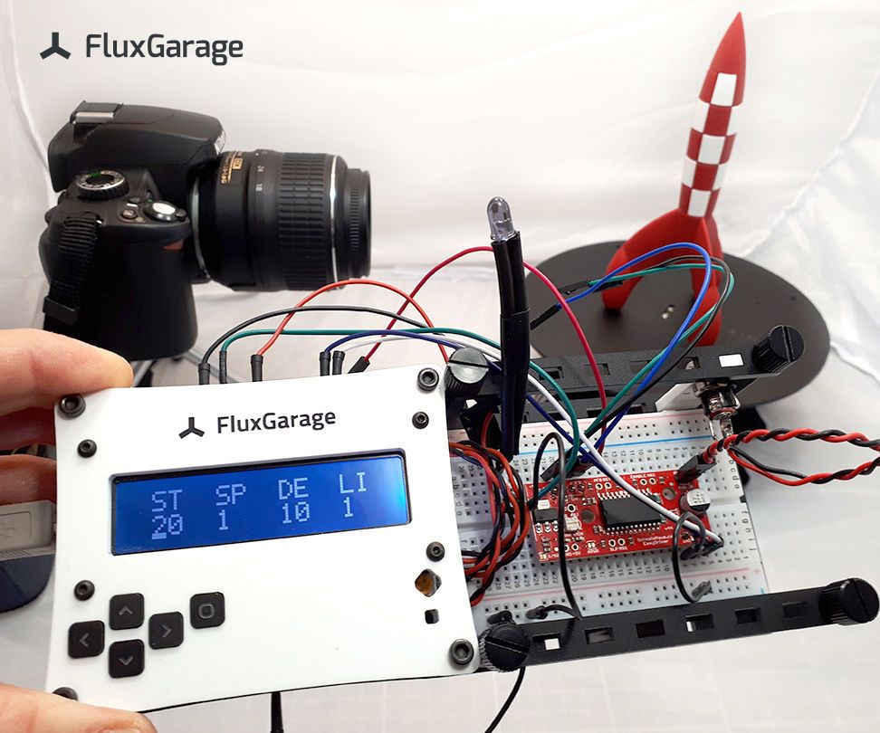

Now we're coming to the most interesting part of this solution. Whereas there are sold many plates that carry an arduino + breadboard, I haven't yet found any system that carries all the other elements that are typically used while tinkering, such as piezo speakers, sockets, switches, potentiometers and so on. By attaching those elements to a "toothbar", you can mount them in a very stable way on the plate's sides. Those parts won't get lost or fly around while worling on your project or putting your stuff back to the locker or drawer. Somehow this solution fills the gap between prototyping and boxing up your projects.

How to fix the "toothbars":
To fix the "toothbars", just plug them into the squareshaped holes, lay the "toothbridge" on them and fix it with the pan head screws on the distance bolts. For the small "Tinkerplate", the template contains a top-cover that can also be used if you prefer a more boxed up appereance (see images in step 1 and 5). This makes most sense if you additionally use one of the display frontplates as well.
Step 5: Now Create Your Own Prototyping Economy
I personally have many of those plates and work with them every day. For example, I use one tinkerplate set for my "stepper motor + camera trigger controller". I like the fact that I have some kind of boxed up and stylish device that holds every project together and can be easily put into the drawer while still being an open system that can be extended and further developed. As already said, this system fills the gap between raw prototyping and developing a final enclosure.
