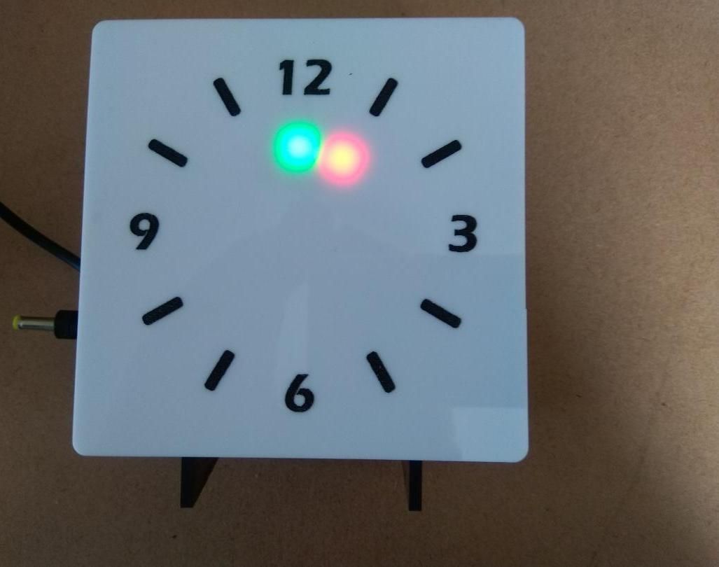

Step 5: Connect Power Supply to LED Controller Board
Tighten DC socket to Enclosure and solder two pin jumper wire and connect to controller boardfinally close the enclosure with 3 mm screws 2 nos
Step 6: Reading Clock
top 8 leds shows secongs display it is changed in 1000 milli second it shows red color in am and blue color in pm
fibonacci spiral yellow color shows hour, cyan color shows minutes and green color shows hours and minutes both. the bottom four squares represent one minute each.
