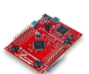

Step 2: Hardware Components
  • Tiva C board
  • Breadboard
  • Jumpers
  • Seven Segment Display
Step 3: Schematic of the Circuit
  • Connect pin A on 7Seg with PB0 on Tiva C
  • Connect pin B on 7Seg with PB1 on Tiva C
  • Connect pin C on 7Seg with PB2 on Tiva C
  • Connect pin D on 7Seg with PB3 on Tiva C
  • Connect pin E on 7Seg with PB4 on Tiva C
  • Connect pin F on 7Seg with PB5 on Tiva C
  • Connect pin G on 7Seg with PB6 on Tiva C
  • Connect common pin on 7 seg with 3.3 V on tiva C
