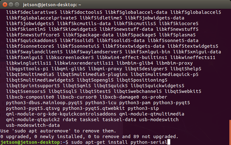

In a terminal enter, the following commands

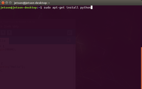

$ sudo apt-get install python

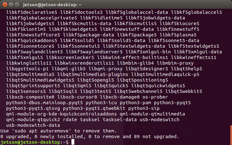

$ sudo apt-get install python-serial

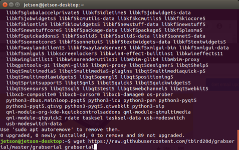

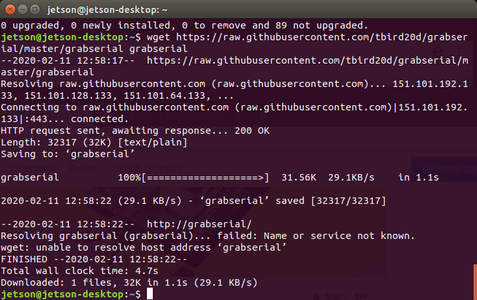

$ wget https://raw.githubusercontent.com/tbird20d/grabserial/master/grabserial grabserial
this should install all the required lib

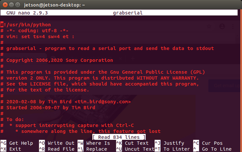

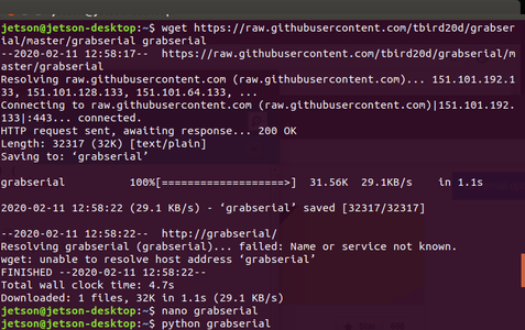

$ nano grabserial
this should open the 'grabserial' file, in this file find the line that says ( images for reference )
1 - sd.port
2 - sd.baudrate
modify these to the port number of your Arduino and the baud rate the Arduino is running at
after the modification u can save and exit the file
to do so press " ctrl + x " and press '' y '' to conform and hit "enter"
Step 4: Read the Data

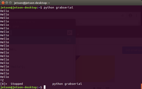

just enter the command :
$ python grabserial
and u should be able to see the serial data on ur terminal
