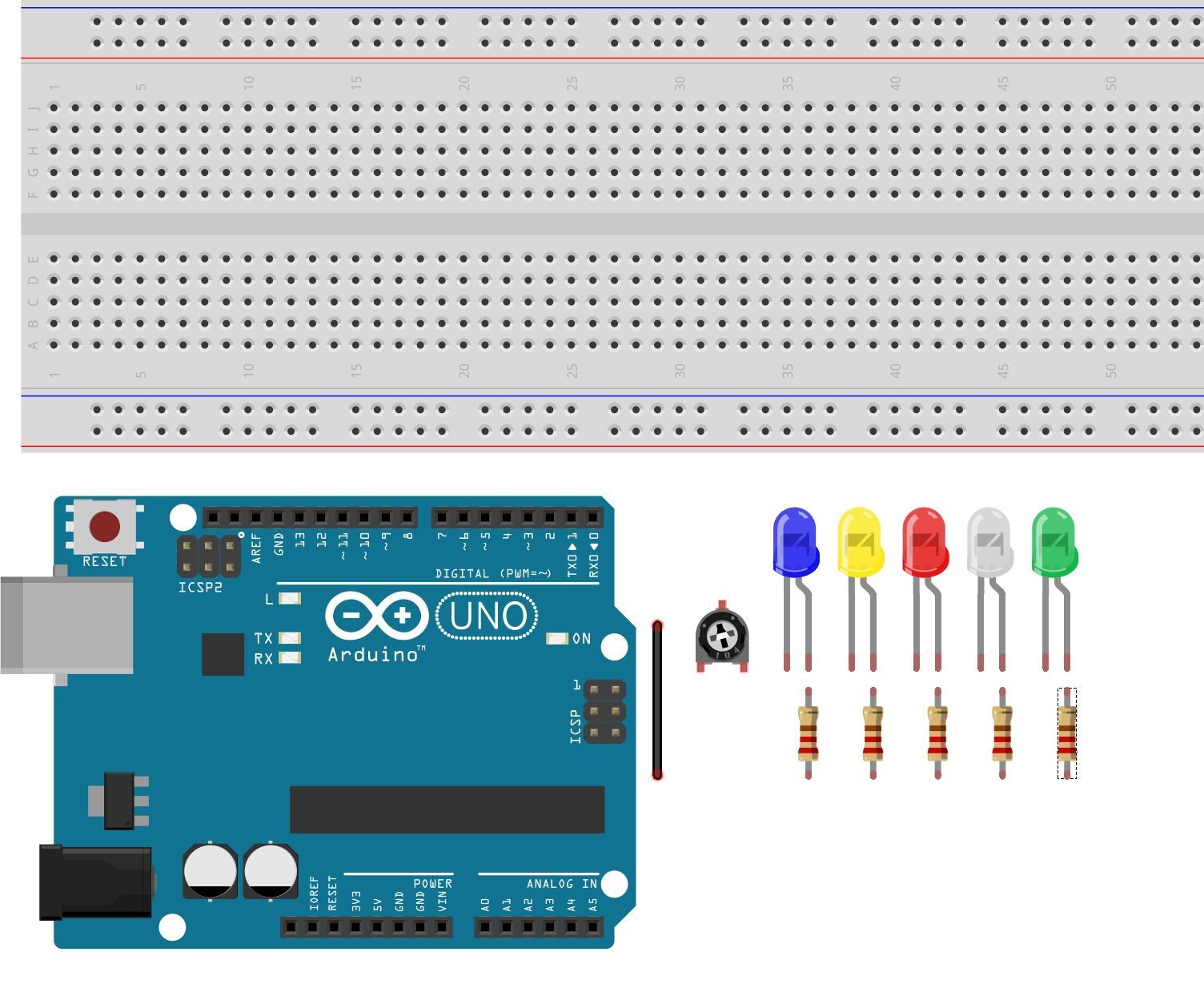

Step 1: Step 1: Adding the LEDs
  1. Add a red, yellow, and green LED to the breadboard.
  2. Connect the smallest lead (short end) of the LEDs to the ground rail using Jumper Wires.
  3. Connect the largest lead (long-bended end) of the LEDs to a 220 (Ohm) Resistor crossing the gap in the breadboard.
  4. Connect the 220 (Ohm) Resistor to the Arduino using a Jumper Wire.
    • Connect the Red LED to Pin 13 on the Arduino.
    • Connect the Yellow LED to Pin 12 on the Arduino.
    • Connect the Green LED to Pin 11 on the Arduino.
  5. Finally, connect a Jumper Wire from the GND rail on the breadboard to the GND pin on the Arduino.
Step 2: Step 2: Adding the Rest of the LEDs
For this step, finish connecting the other 9 LEDs the same way as you did in step 1.
Here's how to connect the LEDs to the Arduino:
  1. For the second set of LEDs:
    • Red = Pin 10
    • Yellow = Pin 9
    • Green = Pin 8
  2. For the Third set of LEDs
    • Red = Pin 7
    • Yellow = Pin 6
    • Green = Pin 5
  3. For the Fourth set of LEDs
    • Red = Pin 4
    • Yellow = Pin 3
    • Green = Pin 2
Step 3: Step 3: Add the IR Receiver
  1. On the IR Receiver, there will be 3 pins labeled "G", "R", and "Y".
  2. Connect the G pin on the IR Receiver to the GND pin on the Arduino
  3. Connect the R pin on the IR Receiver to the 5V pin on the Arduino
  4. Finally, connect the Y pin on the IR Receiver to pin 1 on the Arduino
