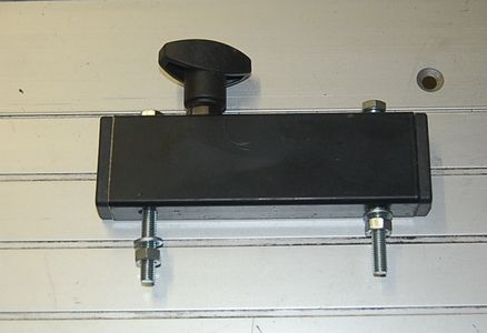

8. accessories
8.1 connection
material:
Profile 20 x 40 mm
4 x screw M6 x 60
4 x M6 nuts
4 x washers for M6
On the table specifies the location of the use of adapters.
In the profile table and drilled holes Ø 7 mm
Each fitting is attached with 2 screws
Note:
These fittings are designed to be anchored accessories
8.1 connection
material:
Profile 20 x 40 mm
4 x screw M6 x 60
4 x M6 nuts
4 x washers for M6
Note:

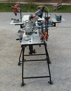

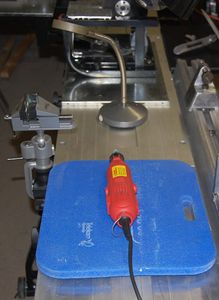

Step 1: 9. Accessories
9. accessories
9.1. vice
9.2.light
9.3.magnifier
9.4.outlet
Each of the tables has its own outlet. Left Part 6 x ,Right Part 5x
9.1. vice
9.2.light
9.3.magnifier
9.4.outlet
