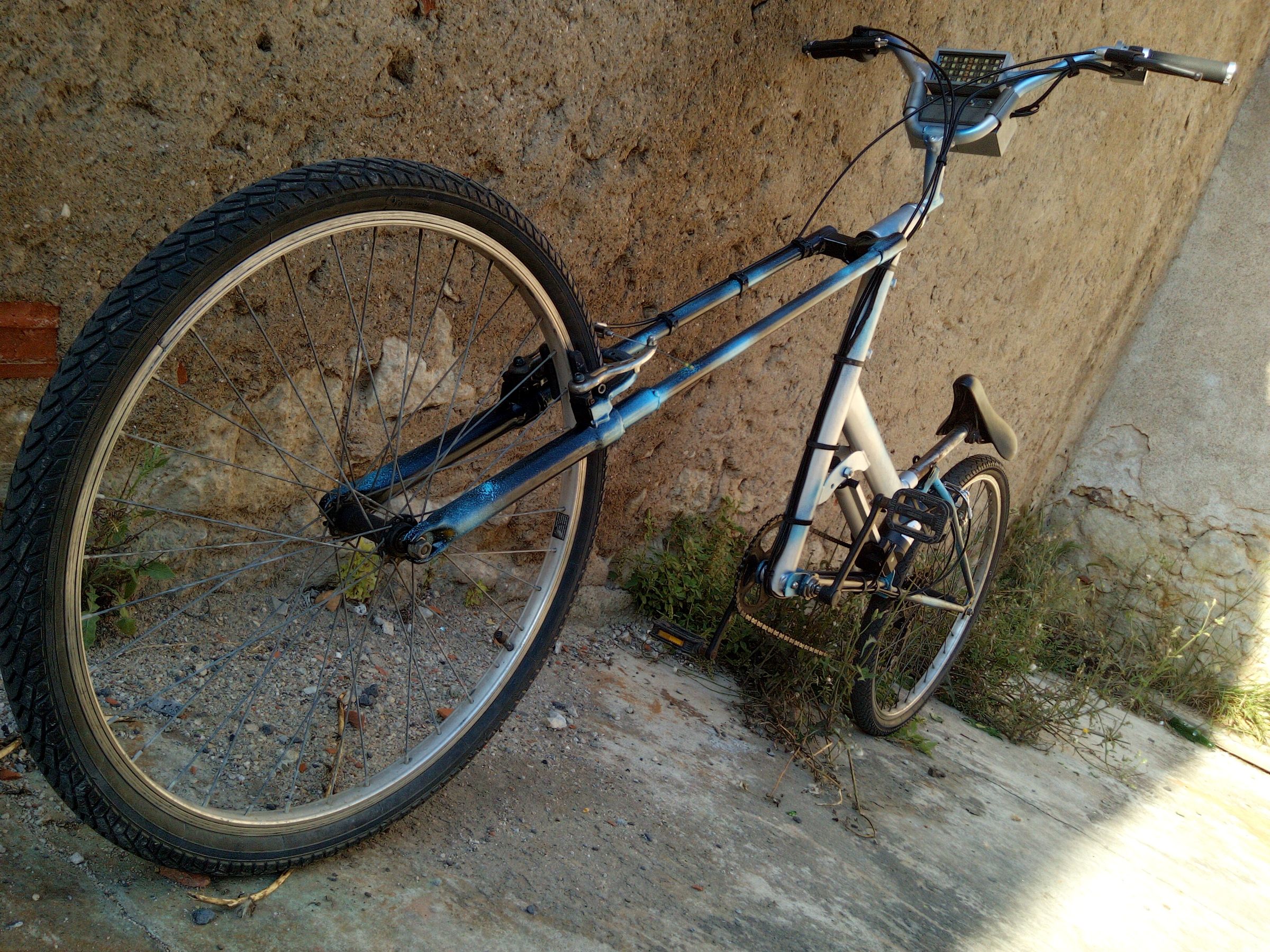

Introduction: Transforming Bicycle! Tall Bike to Chopper Bike
This bike transforms from a tall bike to a chopper/low rider (and back) while you ride it! It is made with a full suspension mountain bike and a set of gas shocks. The spring on the mountain bike is removed to allow the bike to pivot, the fork and rear triangle of the bike are extended. The gas shocks are extended when the bike in the tall position and compressed in the chopper position.
In this instructable, I will describe the general steps for building this type of bike. Specific materials and sizes used will vary depending on what materials you have access to, the specific bike used, and the rider’s size.

Now you need to figure out where to mount the gas shocks to the bike. Distances between potential mounting points on the bike were measured to find possible extended and compressed lengths for gas shocks. The wheels and seat were reinstalled to make this process easier, the cranks and pedals were reinstalled to make sure they would not hit the shocks in either position. You can see my measurements in the photo, I ended up using shocks with 37 inch extended length and 20 inch compressed length, purchased from LS Technologies.McMaster-Carr is also a good option.
The force of shocks will depend on the mounting angle and the weight of the rider. I just guessed on what force to use, if anyone can help with the math of determining the force please share in the comments!
First I bought two 120 lb shocks, and I (120 lbs) could not get the bike to go down. Someone else (160 lbs) tried it and got it to go down and come back up! 160 lbs is 66% of the force of the two shocks.
Then I bought two 90 lb shocks, so that my weight is 66% of the force of the shocks. They worked well for riding slowly, but riding faster over small bumps and cracks in the road made the bike slowly compress. I tried one 120 lb and one 90 lb shock (so my weight is 57% the force of the shocks) and I could not get the bike to go down. I even tried wearing a backpack with a 10 lb weight in it (61%) and still couldn't get them to compress. So I stuck with the two 90 lb shocks.

I put the left pedal down, hold on to the handle bars with both hands, put my right foot on the bmx peg and push the bike like a scooter to get it going. Then I step onto the peg with my right foot, step onto the left pedal with my left foot and take my right foot off the peg and over onto the right pedal.
Shifting my weight back just a little is enough to compress the gas shocks and transform the bike to chopper. To go back to tall bike, I just stand up on the pedals which takes my weight off the shocks, allowing them to expand.
It's best to get off when the gas shocks are extended (tall bike position). When the bike is in chopper position, the only thing keeping it there is your weight. If you stop in chopper, once you put your feet on the ground, weight is taken off the bike, the shocks expand and the bike goes up and knocks you off. You have to learn to hop off pretty quickly to avoid being knocked off and falling. In order to take the photo of the bike in chopper, I had to lock it in place with another person's help.
