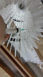

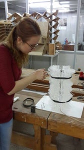

Step 4:
I placed them together with placement order and fixed them with rubber band. To glue them together i used chloroform.
Important note: Don't smell it. It has narcotic effect. Use it in outdoors.
Video link: How to use cloroform?
I used it with syringe. A little drop was enough at intersection points of parts. It was left to dry off. To fix it better, glue them in both sides.
