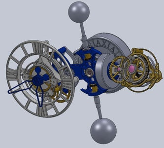

Introduction: Triaxial Motorized Tourbillon
It seems like Jacob and Co never makes the exact same watch twice. There are almost as many variations of Astromomia watch, as there are pictures of it on the web. I based this Motorized version on the model of the Jacob and Co. Astromomia watch in this video: https://www.youtube.com/watch?v=qvx0jXbKkV0
My build can be seen here:
Most of the clock face parts will be the same as those in the Quartz Upgrade, this design includes a version of the clock face (Clock Face w Embedded Numerals) that can be printed in 2 colors where the second color determines the color of the numerals.
After seeing what he did, I created the Triaxial Quartz Movement Upgrade (https://www.thingiverse.com/thing:3677946) for the original Triaxial, to provide a clean design for incorporating a quartz movement.
This version still uses 2 stepper motors, but running in parallel to drive the Carrier and provide more torque.
I want to thank ruzickjc, A26, Dexter_New_Materials, and bld.
- ruzickjc for his help developing the code and the design changes that he made to get the Motorized concept to work.
- A26 who's original Triaxial design provided the inspiration for this design: https://www.thingiverse.com/thing:3061474
- Dexter_New_Materials for the Moon model I remixed: https://www.thingiverse.com/thing:1014620
- And bld for the Earth model I remixed: https://www.thingiverse.com/thing:17336

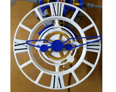

Step 2: Clock Face
The order of assembly is important, so I recommend following the steps below for better results. Also you need to partially assemble the Clock Face, and prepare some of the other components for when you attach the Clock Face to the Carrier during the final assembly process. This section describes that preparation.
Clock Face Selection
The TE Face Face can be printed in 3 different ways:
No Numerals
This is the simplest approach, simply print the TE Face Face.STL file.
Inserted Numerals
Print the TE Face Face.STL and TE Face Numerals.STL files. Choose a contrasting color for the numerals. This approach takes some time, because you need to fit each numeral to the Face, by scraping and filing them, then pressing each numeral into the Face with a small flat head screw driver.
Printed Numerals
This approach uses a 2 color print based on the TE Face Face w Numerals - Face.STL and TE Face Face w Numerals - Numerals.STL files. Choosing a contrasting color for the TE Face Face w Numerals - Numerals.STL file.
The Clock Face Initial Assembly
1) Insert the quartz movement into the TE Face Movement
Cover, and use the nut that comes with the movement to attach it to the cover. There is no need to use the washers that come with the movement because the design of the Movement Cover will not let it rotate.
2) Use 4 M2x8 Flat head screws to attach the TE Face Movement Cover Bottom to the TE Face Movement Cover.
3) Insert the battery into the quartz movement.
4) Press the TE Face Movement Cover into the slots in the standoffs of the TE Face Face until it hits the bottom of the face.
5) By running an electric drill backwards, or just spinning it by hand, use a 2mm drill bit to ensure that the 2mm x 37mm shaft slips into the hole in the TE Face Bridge.
6) Slip the TE Face Hourgear3 on the quartz movement shaft (flange up) and attach the TE Face Bridge to the TE Face Movement Cover using 2 M2x10 Flat head screws.
7) Fit the TE Face Hourgear 2b to the TE Face Hourgear2a. You may have to do some filing so they fit snugly.
8) Run an oversized 2mm drill, e.g. 2.5mm max, through the TE Face Hourgear 2b/TE Face Hourgear2a assembly to ensure that the 2mm x 37.5mm shafts slides easily through them.
9) Fit the TE Face Hourgear2b gear against the TE Face Hourgear3 gear and slide the 2mm x 37.5mm shaft into the TE Face Hourgear2a gear, align it with the hole in the TE Face Bridge and press it in.
10) Press a 2x1mm Bearing Spacer onto the 2mm x 37.5mm shaft with the narrow side of the spacer facing the TE Face Hourgear2a gear.
11) Press the Hand Hour onto the Movement pointing to 12:00.
12) Press the Hand Minute onto the Movement pointing to 12:00, then set the time.

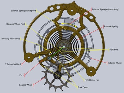

Step 4: Escape Wheel
The Balance Spring and Balance Wheel must be properly aligned for the escapement to run properly.
Familiarize yourself with this step before doing step 6.
To do this, position the Balance Wheel so the Balance Wheel Post, that engages with the Fork Pins, is pointing directly at the Fork shaft, as indicated by the green dashed line in Figure 4. This requires rotating the Balance Wheel so the hex position between Balance Wheel and the Balance Spring to the proper position.
After the Balance Wheel is attached to the Balance Spring, fine adjustment can be done by rotating the Balance Spring Adjuster Ring.
The Figure illustrates the ‘at rest’ position of the Balance Wheel and Balance Spring.
Step 5: Getting It to Tick
This is the most critical part of the design. It is made easier if you have printer that generates accurate prints. With my printer, I needed to drill out the all parts so the shafts spun freely, but I did not need to file any of the parts.
There are 4 major parts involved, the Balance Wheel, the Balance Spring, the Fork, and the Escape Wheel. The names in this section refer to the Figure.
· Make sure that any surfaces that contact between the Balance Wheel, Fork, and Escape Wheel are free of burrs, bumps, or any other printing artifacts that may cause a surface not to be smooth. If not, then some filing or scraping with a knife may be necessary to smooth the parts.
· Make sure that the Balance Wheel, Fork, and Escape Wheel each rotate freely when installed by themselves. The Wheels should spin easily, and the Fork should flop back and forth as the assembly is rotated.
I ran a 2.5mm drill through the Fork and Escape Wheel shaft holes, and a 3.5mm drill through the Escape Wheel shaft hole to ensure that any printing artifacts were cleared out of the cavities.
· Note: Run the drill backwards in plastic at first, otherwise it may auger in at some weird angle and ruin the part. Once the drill is running smoothly backwards, reverse it to clear out the plastic shards.
· All bearings need to fully seated and square, so that their top surface is flush with the respective part. You may need to pop them out and scratch out underneath them with a knife.
· With just the Fork and Escape Wheel installed:
· Turning the Escape Wheel backwards (clockwise in Error! Reference source not found.), should cause the Fork to snap back and forth easily.
· And turning it counterclockwise should cause it snag against a Fork Tine. If the Fork snaps back and forth a little, it is OK. But if it never snags the Balance wheel when rotated counterclockwise, then the Fork Tines may be too short.
· With just the Balance Wheel and Fork installed (No Balance Spring), spinning the Balance Wheel back and forth should cleanly engage the Fork. If there is any sign of a snag, or slowing down, then inspect where the two parts are rubbing, and file the offending part lightly. It is easy to take off too much. If you do, just print another part, and start again.
· Depending on the direction the Balance Wheel is spinning, one of the Fork Pins and the Fork Center Pin should slide along the surface of the Balance Wheel shaft, but not touch so much that they slow the Balance Wheel down. The two contact points formed by the Fork Pin and the Fork Center Pin act to hold the Fork at an angle where its Tines can snag/block an Escape Wheel tooth.
· When the Balance wheel is rotated in the opposite direction, the Balance Spring Post engages with the Fork Pins to swing the Fork in to its opposite position. The swinging action of the Fork causes the Escape Wheel to advance one tooth, and engage with the opposite Fork Tine.
· If there is any binding when the Fork swings, you will need to file the Center Pin a little shorter.
· Sometimes the Fork will swing too far and jam the motion of the Balance Wheel. M2x8mm Blocking Pin Screws may be added to limit the swing of the Fork. I added this option, but I didn’t need to use them in my make.
· When all the parts are assembled, a very light amount of torque on the Escape Wheel in the counterclockwise direction should cause the fork to swing, and the Balance wheel to rotate. Continuing to put torque on the Escape Wheel will cause the Fork to move to its opposite position when the Balance Wheel swings back, due to the Balance Spring. As long as you put consistent, light torque on the Escape Wheel, the assembly should continue to tick.
Other Troubleshooting Suggestions
If it is refusing to work, often the problem is with the basic alignment of the parts. In the 'at rest' position of the balance wheel/shaft with the balance spring attached and the Balance Spring End Mount screwed in, the 'balance shaft post' should point straight at the fork shaft. If it is way off, you have probably pressed the Balance Spring onto the wrong hex position of the Balance Shaft. If it is off just a little, you can try rotating the Balance Spring Adjuster Ring.
Sometimes I have either bent the Balance Spring installing it, or it has taken a 'set' (by sitting in a wound up or unwound position for too long) causing it to position the Balance Shaft Post at the wrong angle. The only solution in this case is to reprint the Balance Spring. I don't use glue for the Balance Spring for two reasons; if I need to replace because of the problems mentioned above, and (according to A26) it is the normally the first thing to wear out.
Make sure that the Balance Spring is at a right angle at the Balance Spring Attach Point. If it is twisted, the Balance Spring will be pushed to one side or the other, rather than the neat spiral shown in Figure 4.
The bullets above basically say; make sure the escape wheel, fork, and balance wheel rotate freely as individual parts. Then combine them, 2 at a time, and make sure they don't bind each other.
For instance, ensure that the Balance Shaft Post does not bind when it turns and pushes the Fork Pins back and forth. The slightest drag will make a difference. Sometimes I have had to either file off, or scrape off with an Exacto/razor knife, the bottom of the Fork Center Pin, and/or the top of the Balance Shaft Post. And ideally the length of the Fork Tines only lets the escape wheel turn one tooth each time it is swung back or forth by the Balance Shaft Post.

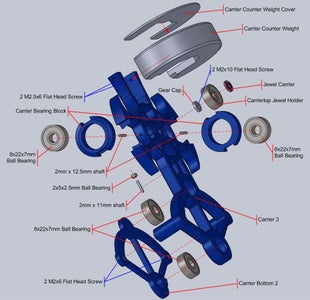

Step 7: Carrier
Many of the parts in the Carrier Assembly may be pre-assembled, as described in this section, and the remaining components will be assembled during the Final Assembly stage.
Carrier Assembly
1) Press the two 8x22x7 Ball Bearings into the Carrier 3 until they hit the stops.
2) Slide a 2x5x2.5mm Ball Bearing onto the 2mm x 11mm shaft, then press the shaft into slot on the bottom of the Carrier.
3) By running an electric drill backwards, or just spinning it by hand, use a 2mm drill bit to ensure that the 2mm x 12.5mm shafts slip into the holes on either side of the Carrier.
4) Clean any flashing off the Carrier Bearing Blocks, so they can snap tightly into the Carrier.
5) Press an 8x22x7 Ball Bearings into each of the Carrier Bearing Blocks until they are flush with the flat side. This should be a tight fit, but if it is not, then apply a little glue to them, only around the perimeter. Be careful not to get glue on the bearing shield because it could cause it to bind.
6) Now snap the Carrier Bearing Blocks into the Carrier.
Carriertop Jewel Holder
1) Press the Jewel Carrier into the Carriertop Jewel Holder. This may require a little scraping of the jewel with a knife to get it to fit.
This assembly will be inserted into the Carrier after the Carrier Assembly is attached to the Base Assembly.
Carrier Globe Shafts
I included two versions of the Carrier Globe Shaft, however I used the Carrier Globe Shaft half.STL file. Printing two parts, and then gluing them together.
1) Prepare the Carrier Globe Shafts.
· You may have to file it to ensure that it fits in to the Carrier Globe Gear and into the 8x22x7 Ball Bearing.
· If you want the set screw flush with the Carrier Globe Gear, press the Carrier Globe Gear onto the Carrier Globe Shaft, and use a 1.5mm drill to carefully drill a hole for the set screw into the Carrier Globe Shaft.
2) Press the 2mm x 12.5mm shaft into the end of the Carrier Globe Shaft.
3) Seat the M2x4 set screw into the Carrier Globe Gear.
Earth
1) Glue the Earth North and Earth South parts together. Make sure they are aligned.
2) Glue the Earth to a Carrier Globe Shaft.
Moon
1) Glue the Moon North and Moon South parts together. Make sure they are aligned.
2) Glue the Moon to a Carrier Globe Shaft.
Counter Weight
The Carrier Counter Weight holds about 300 grams of #4 lead shot. It is large because the movement and its battery is heavy.
1) Fill the Carrier Counter Weight holds about 300 grams of #4 lead shot or other heavy material.
2) After filling the Carrier Counter Weight you may want to pour some wood glue, other glue that hardens in air, to prevent the shot from making noise rolling around as the carrier rotates. Make sure that there are no high spots that would prevent the Carrier Counter Weight Cover from fitting tightly.
3) After the wood glue has hardened (e.g. overnight), glue the Carrier Counter Weight to the Carrier Counter Weight.
The Carrier Counter Weight will be pressed on to the Carrier Crown Gear during the final Assembly process.

Clock Face to Carrier
Add the Clock Face assembly to the Carrier assembly.
1) Press the 2mm x 12mm shaft into the TE Face Drive Gear 24T 2 part. About 4 mm should be sticking out.
2) Thread an M2x4mm set screw into the TE Face Drive Gear 24T20T 2 part. Don’t tighten it yet.
3) Insert the TE Face Drive Gear 24T 2 part into the inner 8x22x7 Ball Bearing of the Carrier.
4) Slide the TE Face Drive Gear 24T20T 2 on to the TE Face Drive Gear 24T 2, and tighten the M2x4mm set screw. Rotate the TE Face Drive Gear 24T20T 2 gear to engage the hex on the end of the TE Face Drive Gear 24T 2. The bottom of the TE Face Drive Gear 24T20T 2 gear should be flush with the end of the TE Face Drive Gear 24T20T 2 shaft.
5) Slide the TE Face Hourgear1 Shaft 2 (which should be attached to the Minute Gear 72T 2) into the 8x22x7 Ball Bearing on the end of the Carrier.
6) Slide the Clock Face Spacer onto the TE Face Hourgear1 Shaft 2.
7) Slide the 8x22x7 Ball Bearing of the TE Face Plate onto the TE Face Hourgear1 Shaft 2.
8) Press the TE Face Hourgear1 onto the end of the TE Face Hourgear1 Shaft 2, and tighten the M2x4mm set screw to lock it in position. Note; the top surface of the TE Face Hourgear1 should be flush with the end of the TE Face Hourgear1 Shaft 2.
9) Press the 2mm x 49mm shaft into the Carrier Bottom 2.
10) Align the Carrier Bottom 2 49mm shaft with the Minute Gear 72T 2, and the TE Face Drive Gear 24T 2 12mm shaft, then press it on to the Carrier until the Carrier Bottom 2 is tight to it.
11) Secure the Carrier Bottom 2 to the Carrier with 2 M2x6mm Flat Head screws.
12) Align the 2mm x 37mm shaft of the Clock Face assembly with the hole in the TE Face Plate, and the 2mm x 49mm shaft with the hole in the center of the TE Face Movement Cover Bottom.
13) Press the two assemblies together, and secure the TE Face Plate to the TE Face Face with 4 M2x6mm Flat Head screws.

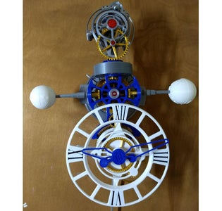

Carrier to Base
1) Fit the Carrier to the Carrier Shaft.
Note: before pressing the Carrier onto the shaft check that the 12 O’clock numerals (‘XI’) on the Clock Face are aligned with the (‘TRIAXIAL’) text on Base.
2) Secure the Carrier to the Carrier Shaft using an M2x10mm Flat Head screw through a Gear Cap.
3) Press the Carriertop Jewel Holder into the Carrier.
4) Holding the Earth Carrier Globe Gear in position, slip the Carrier Globe Shaft through the 8x22x7 Ball Bearing and into the hole for the 2mm x 12.5mm shaft.
5) Spin the Carrier Globe Gear, so it seats in the Carrier Globe Shaft hex, and tightly traps the 8x22x7 Ball Bearing, then tighten the M2x4mm set screw.
6) Repeat steps 4 and 5 for the Moon Globe Gear Shaft.
Fork Frame to Carrier
1) Slide the Carrier Crown Gear 24T of the Fork Frame and Tourbillon assembly onto the Carrier.
2) Use 2 M2.5x6mm screws to secure the Carrier Crown Gear 24T to the Carrier.
3) Press the Carrier Counter Weight onto the Carrier Crown Gear 24T. Note that this will work only if the Carrier Counter Weight is in the correct orientation.
Now, power it up, and pray :-)
