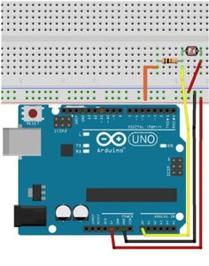

Step 1: Arduino Set-up
  • Connect the laser to 3V and GND
  • Connect the sensor as in the picture
  • The LCD screen can be connected as follows:
  • GND to GND, VCC to 5V, SDA to A4 and SCL to A5
  • Use a 5K-ohm resistor (You can measure the variable resistor using a Volt meter)

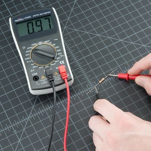

Step 2: Make Sure the Variabele Resistor Is at 5k Ohm
Use a volt meter to measure the resistants through the variable resistor.
