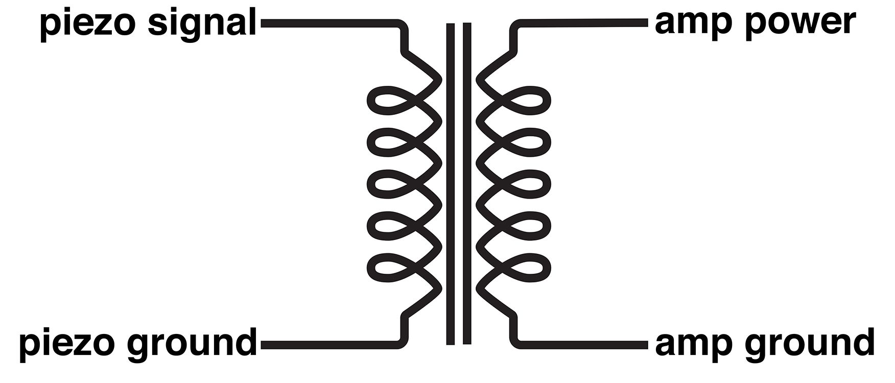

Step 4: Wire the Transformer
Since the transformer is basically two coils in proportion to one another, the only thing to be mindful of is aligning the wires when they are soldered.
Solder one set to the outer pins on one side of the transformer, and the other set mirrored on the opposite side. The colors of the wire should be aligned.
Trim the center pins on the transformer. We are not using these.
In a schematic, a transformer is represented by a double-line core surrounded by two coils.
Step 5: Insert the Jacks
Insert the jacks into the mounting holes in the enclosure.
Make note of which jack is connected to the side of the transformer labeled "P". This stands for primary.
Typically the primary is the input side, but we are actually driving the transformer backwards, so the primary side is our output to the piezo.
The reason the input is the output is because of impedance, a concept we are not really covering in this class, but one particularly important when dealing with transformers and AC electronics. Long story short, impedance is kind of like resistance in AC electronics (but not exactly the same). Typically, audio sources have a high impedance of a few thousand ohms, and speakers have a low impedance around 8 ohms.
The audio output transformer is designed to take a high impedance source and make it low impedance. However, we have the opposite problem we need to solve. The piezo is typically a high impedance device, and the audio amplifier is always providing a low impedance signal to drive a speaker. In order to drive the piezo using the amplifier, we need to take the low impedance output from the amplifier and make it high impedance. To do this, we simply send the low impedance signal from the amplifier into the low impedance coil, and this will produce a high impedance signal to drive the piezo. Simple as that.
