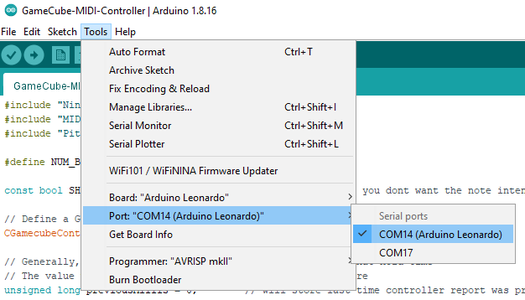

Once the IDE is open, connect your Pro Micro to the computer via a USB cable. You should see it pop up on one of the com ports under Tools -> Port: -> COMXX (Arduino Leonardo).
Click on the port to select it.
Next, go back to Tools -> Board and select the Arduino Leonardo.

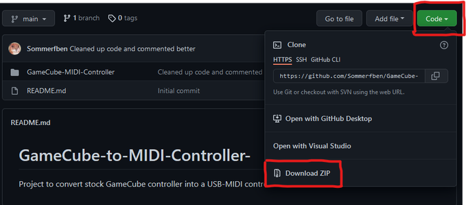

Step 6: Downloading the Code
I've created a GitHub to host the code as there are two files and Instructables doesn't allow uploading of .zip files. You can find the repo HERE.
The easiest way to download everything is to click on the green "Code" button and select "Download as ZIP".
Once thats downloaded, go ahead and extract the files to somewhere convenient.
Then open up the GameCube-MIDI-Controller.ino file with the Arduino IDE

Once the project is open in the Arduino IDE, double check the board and port settings are configured properly
If they are, then you can hit the upload button and program the Pro Micro.

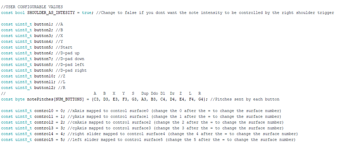

These are very straight forward to change in the code if you would like to. There is a section right at the very top of the code that defines these values under the comment "USER CONFIGURABLE VALUES".
The line
//                                     A   B   X   Y   S   Dup Ddo Dl  Dr  Z   L   R
const byte notePitches[NUM_BUTTONS] = {C3, D3, E3, F3, G3, A3, B3, C4, D4, E4, F4, G4}; //Pitches sent by each button
is the one that defines the note pitches sent for each button. So for example, if you would like the A button to play D2 instead of C3, all you have to do is change the C3 underneath the A to D2. Like this
const byte notePitches[NUM_BUTTONS] = {D2, D3, E3, F3, G3, A3, B3, C4, D4, E4, F4, G4}; //Pitches sent by each button
By default, the code uses the right analog trigger to define the note intensity. If you would like to have all notes sent at a medium intensity and ignore the analog trigger, simply change the following line to false
const bool SHOULDER_AS_INTESITY = true; //Change to false if you dont want the note intensity to be controlled by the right shoulder trigger
The final configuration option is the control slider number in this section.
const uint8_t control0 = 0; //xAxis mapped to control surface0 (change the 0 after the = to change the surface number)
const uint8_t control1 = 1; //yAxis mapped to control surface1 (change the 1 after the = to change the surface number)
const uint8_t control2 = 2; //cxAxis mapped to control surface2
const uint8_t control3 = 3; //cyAxis mapped to control surface3
const uint8_t control4 = 4; //right slider mapped to control surface4
const uint8_t control5 = 5; //left slider mapped to control surface5
So right now, the xAxis of the joy stick is mapped to MIDI control surface 0. To change it to another number, say 13, simply edit the line so it becomes
const uint8_t control0 = 13; //xAxis mapped to control surface13
