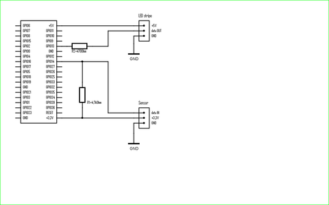

The Circuit
The sensor DS18B20 has three connectors - power, GND and data. Data is connected to Pin GPIO 14 of the arduino. It is important that there is a pull up resistor (R2 = 4,7 kOhm) between power (3,3V) and the input (GPIO 14). Power is connected to 3,3 V and GND to GND.
The LED stripe WS2812B has also three connectors - power, GND and data. Data here is connected to Pin GPIO 13 of the arduino. A resistor has to placed between the output pin (GPIO 13) and the data pin of the stripe. Power is connected to 5 V and GND to GND.
For easier connection I used clamps.

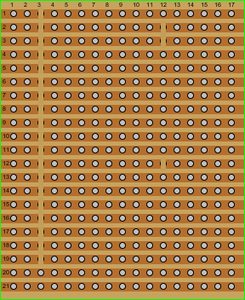

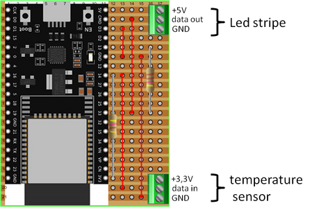

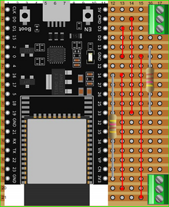

The Board
First of all you have to interrrupt some strips at the bottom of the board. You can use a drill or a cutter. The picture of the botton of the board will show you where interruptions have to be placed.
As the next step you will have to place the wire bridges as you see in the picture. After that the two resistors have to be soldered.
Now you can soldering the clamps and the socket for the ardoino.
Put the arduino to socket and connect the sensor and the led stripe. Be careful of the correct cennection (power, data, GND).
