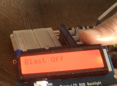

Step 4: Code (Project 2 - Rocket Countdown)
ok, try adding this code instead and uploading, and noting what it does.
(Note, the code doesn't use a FOR LOOP to count down (as I want to keep changing the screen colour each time). If you don't care about the colour of the screen, try and make it count down from 10 using a FOR LOOP.

 screen.print("Blast Off");
 screen.setRGB(255,0,0);
 delay(1000);
