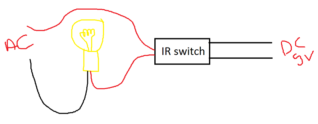

Step 5: Fitting and Wiring
IR REMOTE CONTROLLED SWITCH need an 5 V DC to operate.you can use any IR blaster as switch
AUTOMATIC WATER LEVEL CONTROLLER need 12V DC to operate.you can control any water pump Max load is 1.4kW).use stainless steel bolts as sensor
AUTOMATIC NIGHT LIGHT need 12v DC to operate
