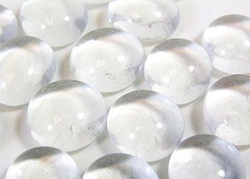

~4 Bags of Clear/Flat beads ($1.00/bag CAD) { DOLLAR STORE } (~$12.00/bag elsewhere)

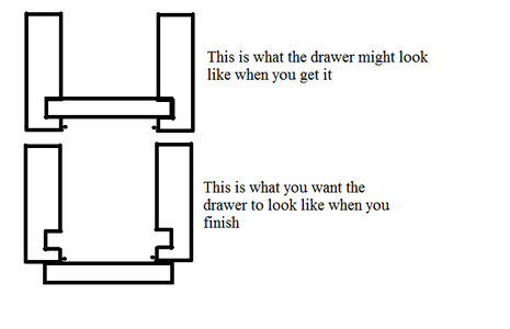

Part 2.3: Destruction and Reassembly of bottom drawer
This wasn't completely necessary but it added a little bit more space to the electronic compartment, which in turn allowed me to add about 4-6 more LED's.
I broke off the back piece of the bottom drawer (with my hands) and slipped out the insert. I then glued that wooden insert to the bottom of the drawer. Make sure you have enough room to do this! (IE the drawer will still fit after this part)

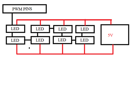

Step 4: PROTOBoard Design
Part 3.1: Conceptualization of Design
Things to keep in mind
Understanding how LED's work, in series and parallel.
Understanding how LED's work in a matrix.
Understanding how an RGB LED has a 3 filament matrix within the bulb itself

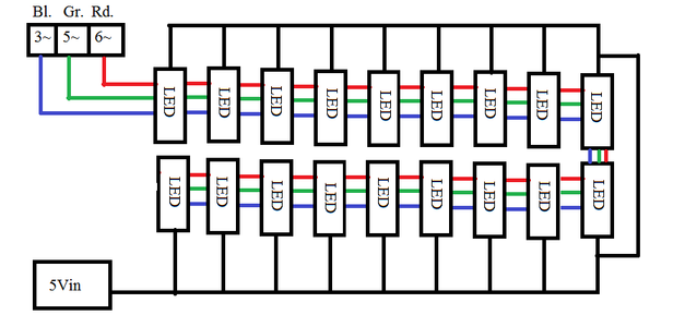

Keep it simple. Through 2 drawings, I was able to have an understanding of where I wanted to go with the design on the protoboard. I didn't want to lose the intensity of the light so I chose to wire my LED's in series.
CONCEPTS
The LED's are wired in series
The common (5V source) is wired in a parallel bridge
Circumstantial Changes to the design:
Removed the Resistors to create a more intense light (Using regulated 5-5.1V power source.)
CONCEPTS

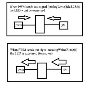

There is a constant signal of going into each of the common anode.
Red is defined as HIGH when the analogWrite(Rled, 255)
This means that there is a signal (or electricity) being sent from the 5V pin (anode) as well as red led pin(cathode), meaning that red LED wont be expressed or turned on, because the LED wont work when it is being bombarded with signals from both sides (signal confusion).
When the red LED is defined as LOW or analogWrite(Rled, 0), electricity is allowed to pass from the common anode (5V source) through to the PWM cathode.
