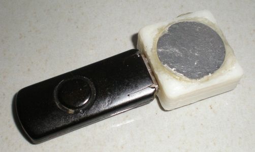

Almost was home, back from a client where I fixed some computer problems. Then I realized that I had left my usb memory stick in my client’s computer. Now I had a hard choice, drive back 100 km or let my client send back the usb stick with lots of information he does not need to know. Do you recognize this and do you have fine soldering skills? Then this instructable is something for you. This is an usb cap that sounds an alarm when it has been empty for 5 minutes. The alarm is repeated every minute. When you always keep the cap with you, you will never forget an usb stick again.

Step 3: Build the Enclosure.
Print the model from the stl file usb_bleeper.stl You might have to scale the model so that the batteries and usb stick fit. You could also make the casing by other means. My initial prototype was made with instamorph moldable plastic

Step 6: Close Battery Cap
Put the batteries in together with a piece of foam. The foam must push the wires against the batteries. Glue the battery cap with some hot melt glue. For replacing the batteries the glue can easily be removed by applying some isopropyl alcohol.
Step 7: Glue the Piezo Beeper
Put some tape over the electronics and glue the piezo beeper on top with hot melt glue. For best sound quality the whole rim of the beeper must be covered with glue.
Step 8: Testing
Whenever you put in or take out a usb-plug the device produces a single beep. When you take the plug out and wait 5 minutes you must here 7 beeps. The timing of this chip is not very accurate.
