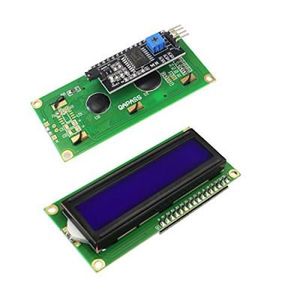

ESP32 Wiring With LCD Sensor
LCD Sensor ESP32
SDA and SCL - SDA and SCL OF ESP32
VCC - 5V
GND - GND

Upload lcd library with uPyCraft IDE :
You can find the lcd libraries on Bharat-Pi github page :
> https://github.com/Bharat-Pi/MicroPython/tree/main/Bharat_Pi_LCD_Display
