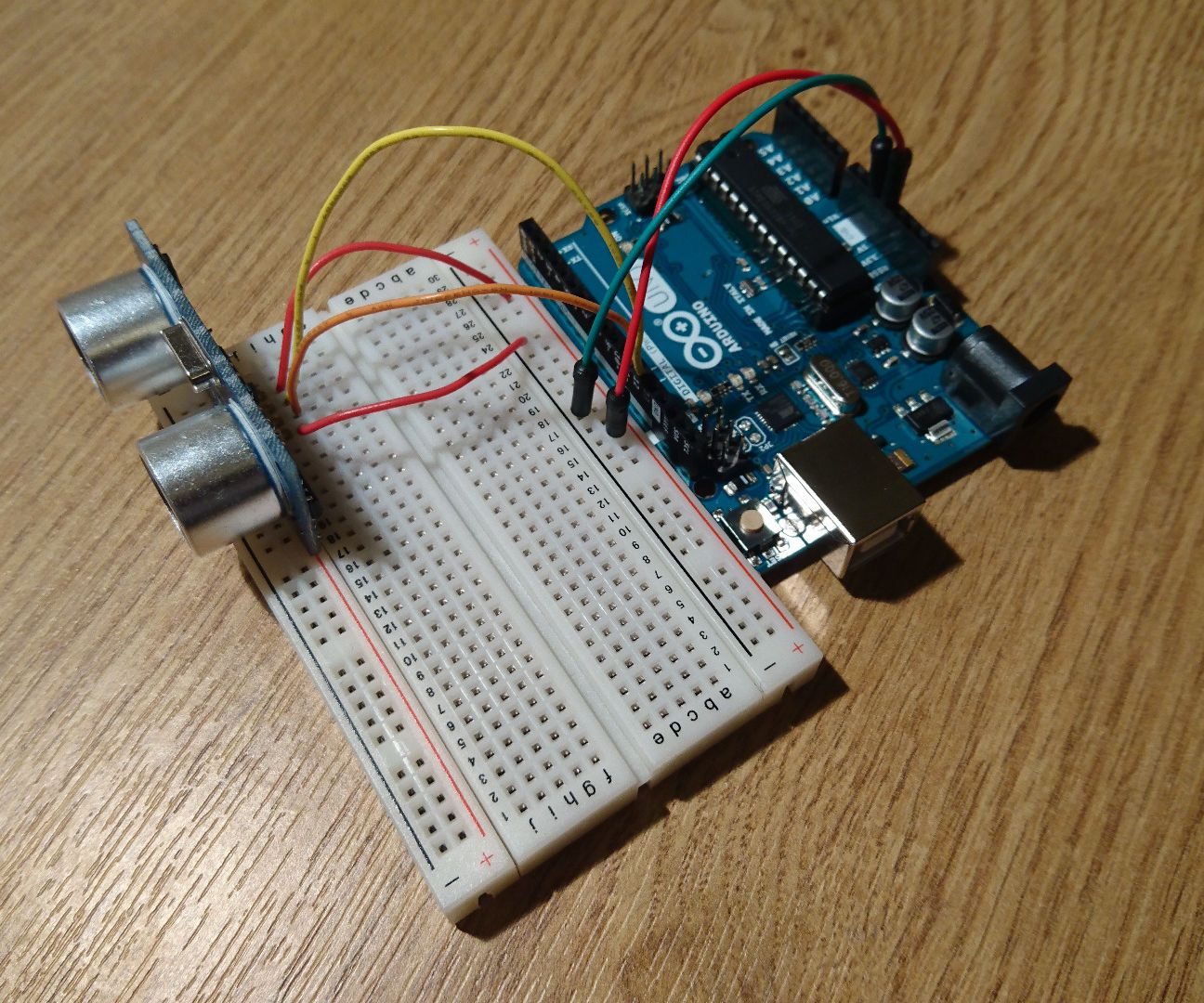

Step 1: Setting Up Your Arduino
To start you need to set up your Arduino so that it can interact properly with the ultrasonic senor. This step is very important and must not be skipped. *HAZARD WARNING* If step 2 is skipped you may find many unused parts strewn around your kitchen cupboards.
Connection List - See above mock up for reference.
Ard = Arduino
BB = Breadboard
Ard 5V Pin -> BB Power strip
Ard GND Pin -> BB Ground strip
Ard Digital Pin 11 -> HC-SR04 Echo Pin
Ard Digital Pin 12 -> HC-SR04 Trig Pin
BB Power strip -> HC-SR04 Vcc Pin
Ard Ground strip -> HC-SR04 GND Pin
