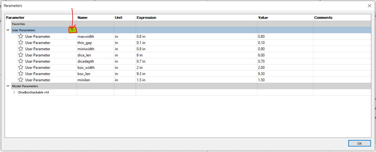

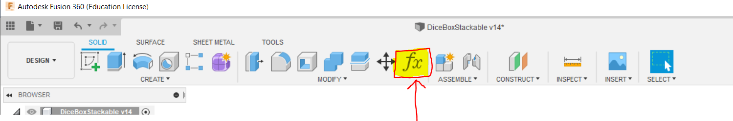

One useful feature of parametric modeling which is very useful in
Fusion360 is the user parameter menu. In this workflow, rather than hardcode numbers in your design that make it very difficult to change later, you can use variables to represent numbers that appear in dimensions multiple times or that may be subject to change.
Some benefits of using these parameters in this design would be:
- If I wanted a bigger box that could hold more dice
- I want to use bigger/smaller dice
- I want to add more compartments to my box
- I use different magnet shapes if I make a different box
Here is a quick look at the workflow:
Open the parameter menu from the 'modify' toolbarAdd a parameter by giving it a name and a measured value
Now, instead of crunching numbers and finding out the decimal values for each dimension in your part, you can just use the variable name you set, and it automatically updates. If, for instance, I wanted to use bigger dice, I could simply change the 'dicedepth' parameter above rather than re-CAD the entire box. Pretty cool.

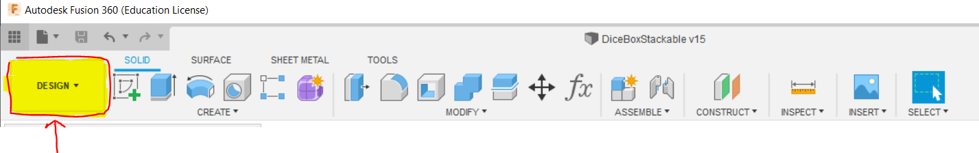

Step 3: Generate CAM
Now that I am happy with the simple, but sleek design for the box, I will work on generating CAM for it
Let's change over to the 'Manufacturing' tab to begin working on this:
