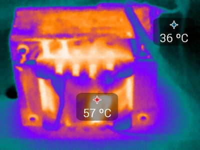

In the photos I have the shots of a 3-phase panelboard.

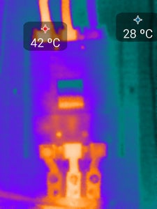

Here I am giving an example on the main breaker for the panelboard. Looking at the thermal images shows significant loading on the red and yellow phases at the lineside of the breaker. On the loadside the yellow (middle) phase shows signficant heating.
Why is this? With thermography we can immediately find problems but we need to use other test technologies to determine the exact cause of the problem(s). Thermography alone cannot be used to diagnose!
Step 3: Auxiliary Tests.
I used my clamp ammeter to measure the currents on the phases. The red was 86A, yellow 106A and the blue 34A. Severe imbalance yeah? I also suspect the lugs needed torque tightening. Voltages were all good on the phases.
