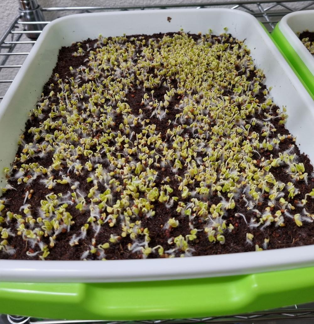

Once the tray is prepared, it goes onto the rack. To ensure the seeds grow into the soil properly, the seeds are covered with a weighted tray. I found that two pounds is enough. I mark the start date on a note, and I leave them alone for two days.
After two days, there will usually be roots showing through the screen, and the weighted tray will be pushed up. At this point I add enough water into the green tray so it just touches the white screen. This will keep the roots wet without flooding the coco coir. The sprouts are covered to keep them in the dark. This encourages them to elongate for easy harvesting. I actually grow the sprouts in what used to be a darkroom.
After about two more days, the sprouts should be reaching above the edge of the trays (see last picture above). They are now ready for light. I use a timer to give them 16 hours of light each day. I also add water. From here on I check them daily to be sure the roots remain wet, and to await the harvest.
Step 5: Harvesting
When the greens are truly green, and have grown into a dense canopy, they are ready to harvest. I just grasp a bunch and use a sharp knife to cut them. Scissors can also work. Then I rinse them to remove any "dirt" and seed shells, and use a salad spinner to dry them. I place them in containers lined with paper towel so they stay crisp, and keep them in the fridge.
In the last picture you can get a sense of the mat that is formed with the help of the psyllium husks.
