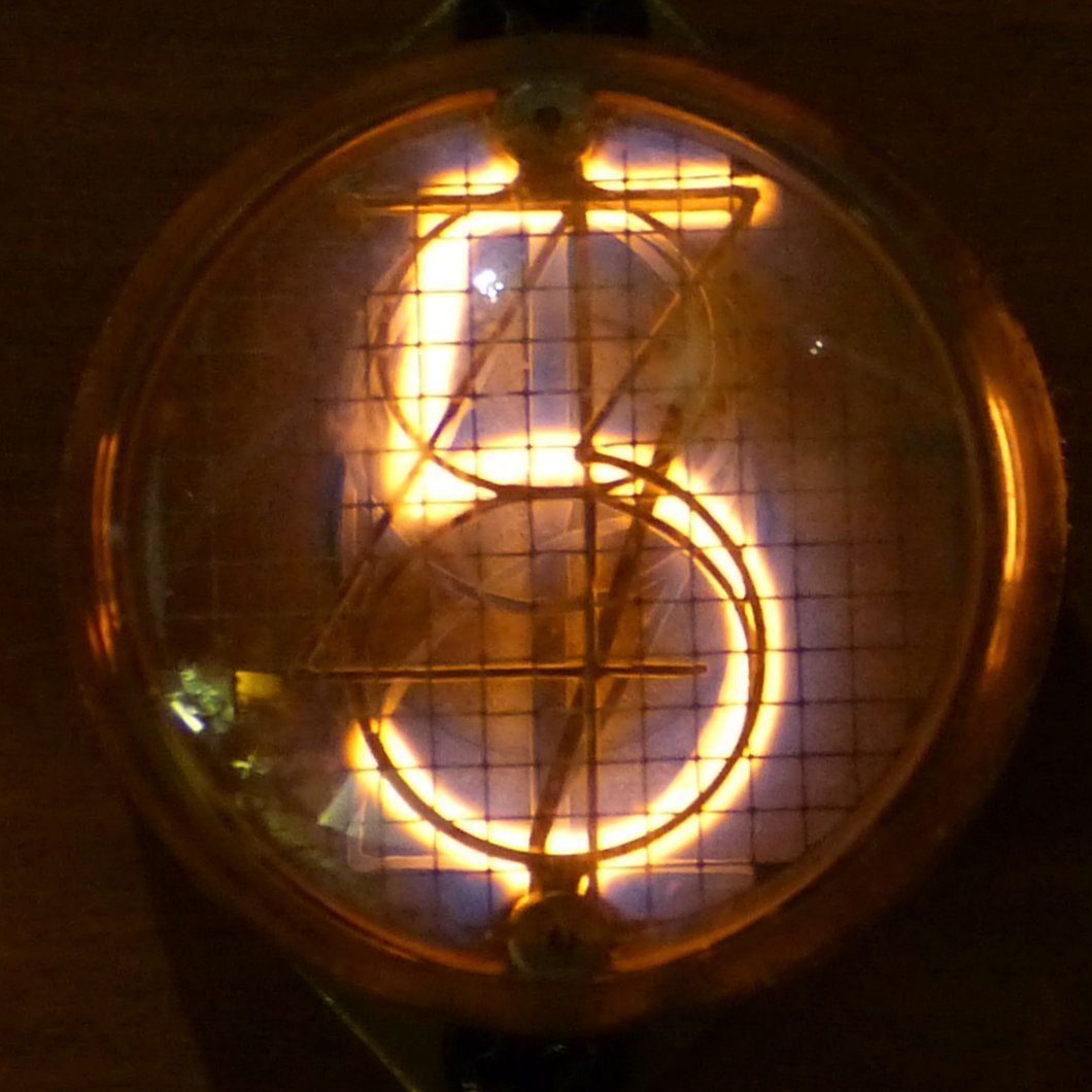

With only 5 volts this bell began to ring nice and loud. As the contact of the bell is just a piece of metal and an adjustable point, it is very noisy (electrically) causing lots of radio interference. Also, the solenoids produces large amounts of back EMF each time the contact disconnects. This caused the controller to crash. It is very important to isolate the interference and EMF as much as possible. To do this, I began to experiment with different value resistors to reduce the current in the solenoids which, in turn, would reduce the emf. Also it would reduce the force of the bell strike. The sound of the bell is a bit too loud for me anyway. (I want to be woken up gently, not like world war 3 was about to kick off) I found that a 6 ohm resistor worked great. The switching of the bell is done via a transistor. (A relay would work better but I didn't have one available so I used a salvaged BU407. Other transistors will also work ) A flyback diode is used across the solenoid to suppress EMF . (see schematic)
Next the solenoids needs to be shielded. I used some stainless steel plate. For the shape, I made a mock up in paper first and then used that as a template. These methods of isolation work but not completely. The nixie tubes flicker a bit but a least the controller does not crash anymore. I could continue experimenting and isolate further, but I actually like the flicker. It gives the clock a bit of vintage character. (In fact, I have seen some nixie clock kits that have deliberate flicker and fade written into the code as an option)
Put the cover back on and decide how you are going to mount your tubes. Originally I was going to surface mount them; but with lack of space inside for the sockets, I started to play around with different pieces of wood and metal. I had a piece of metal in the shed and thought it was a good angle for the display. I drilled holes for the sockets and then small holes in the wooden bell cover for the wires.
