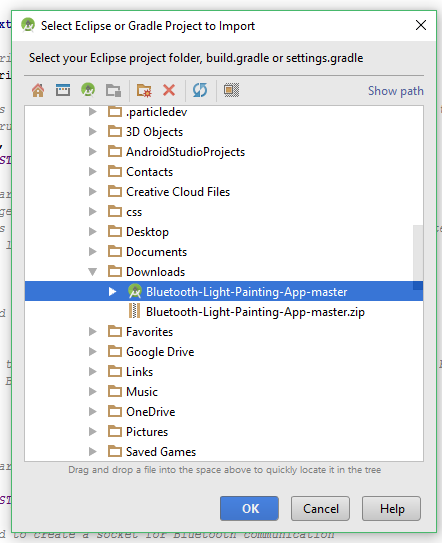

After you have Android Studio installed, head over to the GitHub repository for this project and download the zip file that contains all of the source code for the project. Once the download completes, un-zip the file into the directory of your choice.

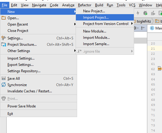

After downloading the repository, open Android Studio. In the File menu, select New > Import Project.
You will be presented with a dialog box. Navigate to the location where you extracted the .zip file obtained from GitHub. Select the top level directory and click the OK button.
You will then be guided through a bunch of other screens for configuring the imported project files. You should be able to stick with the defaults for all the screens that Android Studio selects. Just spam the Next button until you get to the last screen where you can click the Finish button instead.

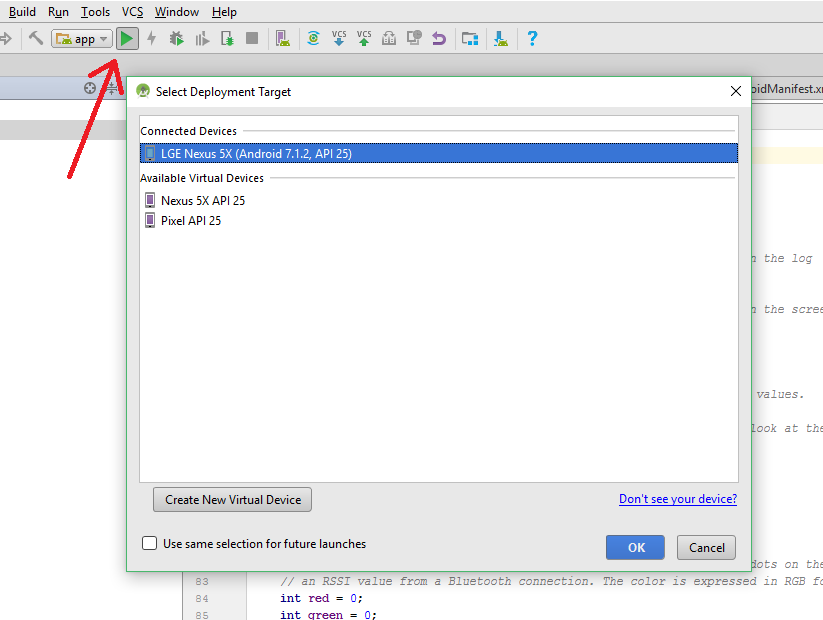

After the project loads into Android Studio (which might take a minute) you can run the application on your Android phone. With your phone connected to your computer via USB, click the Run button in the Android Studio toolbar. It is a green play button. This will launch the Android Device Manager. At the top of the screen, you should see your connected phone.
If your phone does not appear in the list, it is likely you just need to enable developer options in your settings menu to allow Android Studio to connect with your phone. The procedure for doing this varies slightly from phone to phone, but typically you go to Settings > About phone and find an item listing your Android Build Number. To enable developer options, simply tap this item seven times.

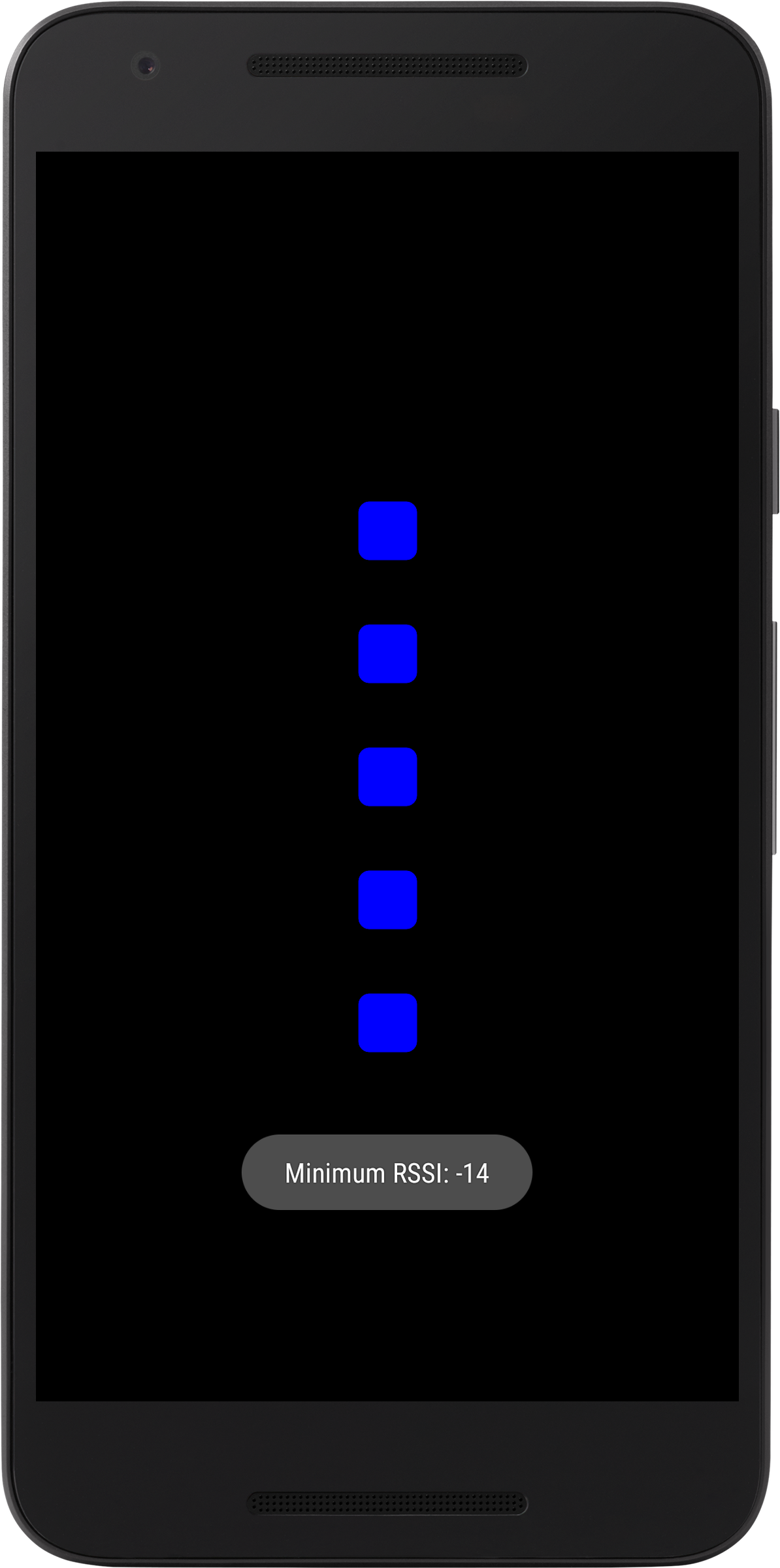

Once you select a device, you will be taken to a mostly-black display with a series of dots in the middle of the screen. If you move the phone around your Bluetooth device, you will notice that the dots change color.
The dots will appear red with a strong Bluetooth signal, green with an intermediate signal, and blue with a weak signal.

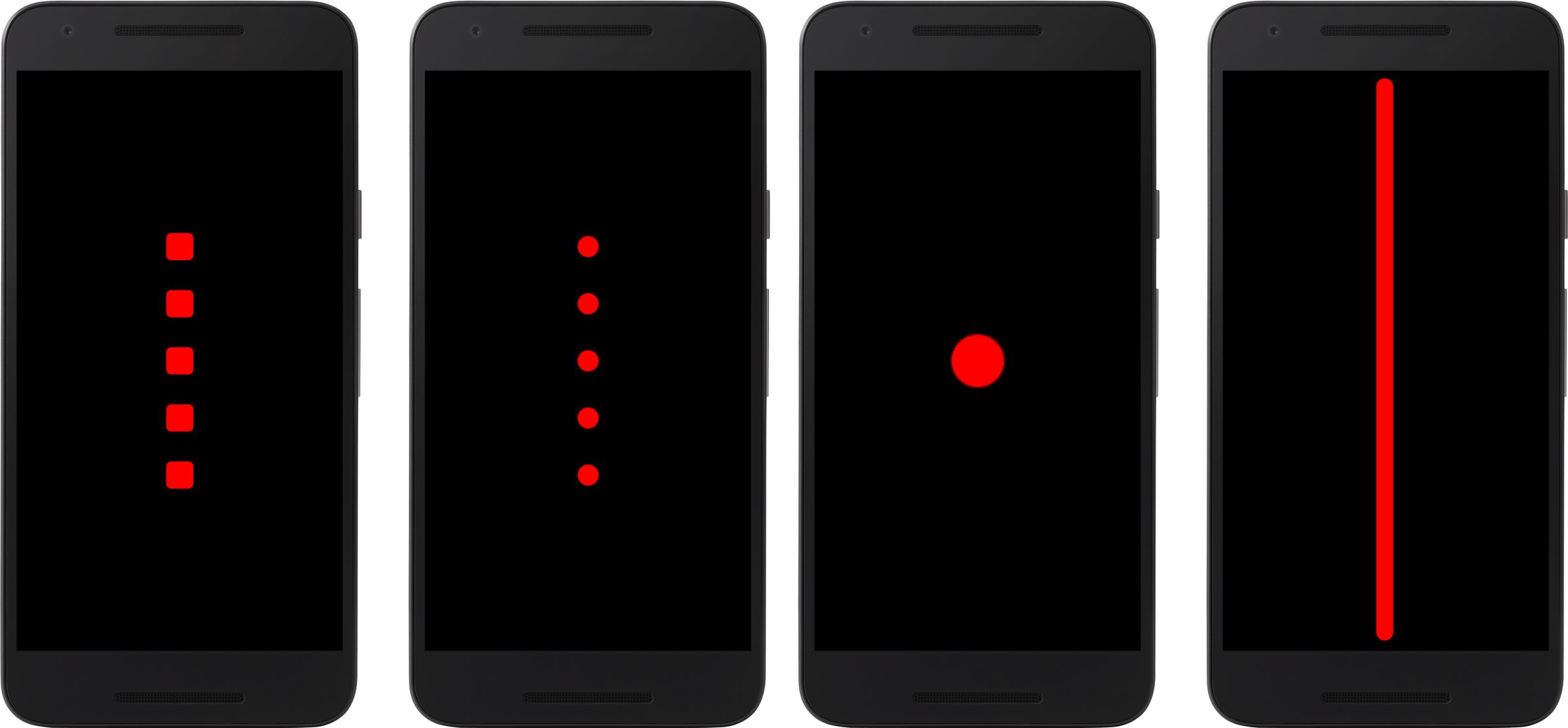

You can change the style of dots by swiping left and right on the screen. The different types of dots (one is a bar the length of the phone) produce very different effects in the long exposure photos.
You can also change the minimum RSSI by swiping up and down. Making the minimum RSSI closer to zero basically shrinks the color scale. The color of the dots will turn blue closer to the Bluetooth device if the minimum RSSI is closer to zero. This is useful if you want to create Bluetooth visualizations zoomed in closer to your device.

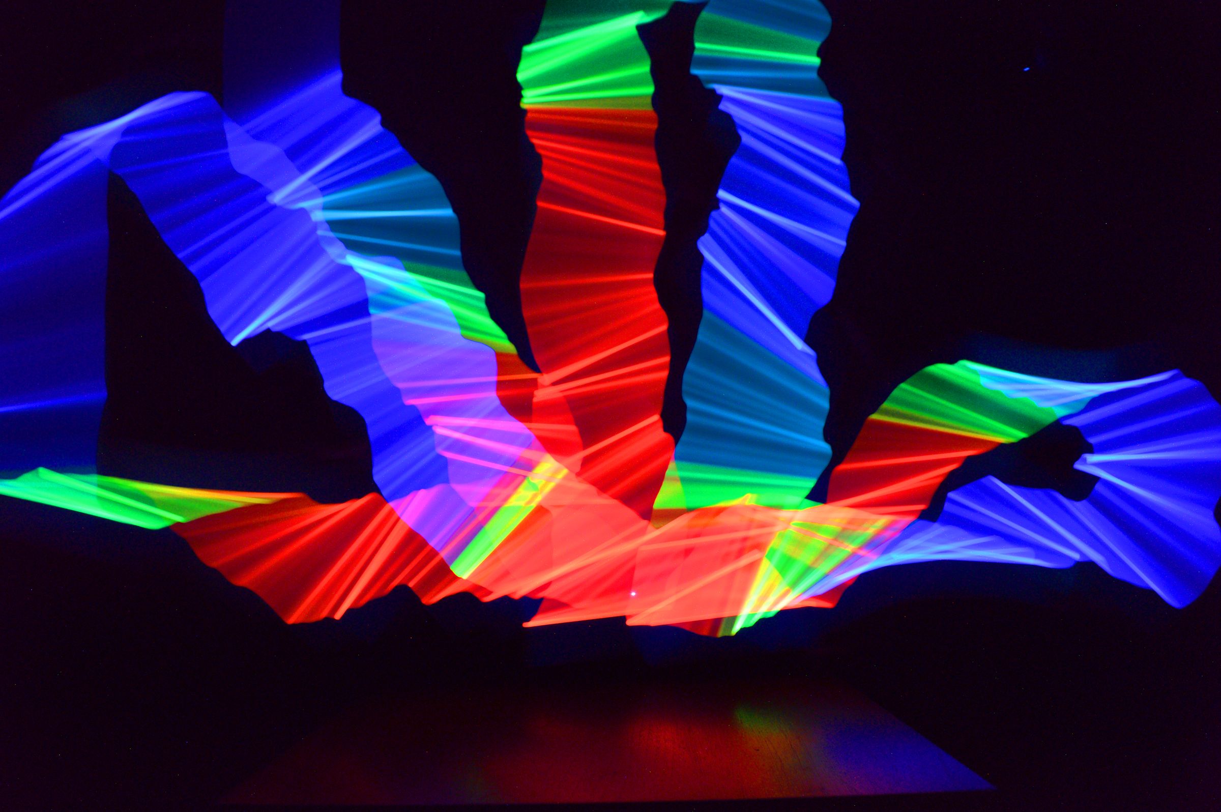

Step 6: Capture Your Long Exposure Photo
The time has finally arrived for the main event of this Instructable, capturing the long exposure photo that will enable you to visualize Bluetooth signals.
To capture the photo, set your camera to bulb setting and turn off the lights. With the shutter open on your camera, move your phone with Blue Paint around in the space surrounding your Bluetooth device. You will want to move the camera at a slow-ish pace to get nice colorful patterns in the photograph. Be sure to experiment with your scene and technique to get different effects.

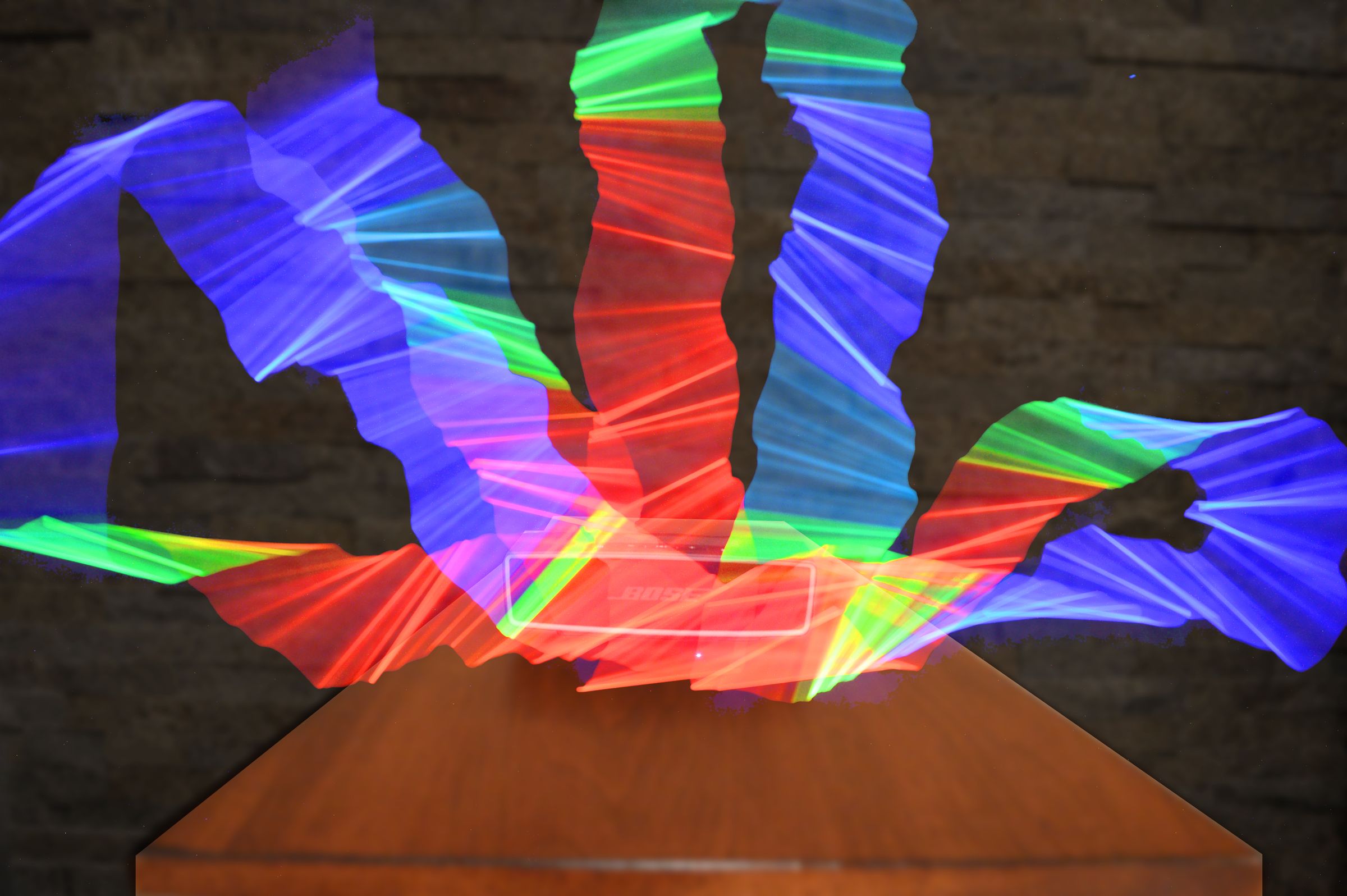

We now have a normal photo of a Bluetooth device with a nicely blurred background, but that is not the point of this Instructable. To add the pattern of colors from the long exposure photograph, first open the long exposure photo in Photoshop.
First, I like to bump up the saturation of the colors a bit. This is done in Image > Adjustments > Hue/Saturation. I usually bump up the saturation to about +50 or so. The increased saturation will make the colors show more brightly in the finished images.
Next, copy the entire photo and paste it into the background image as a new layer. The long exposure layer should be on top of the background.
Finally, we will need to blend the long exposure photo layer into the background layer in a way that eliminates the black background of the long exposure photograph. There are several different blending options that will produce slightly different results. The type of blending you use will depend upon the characteristics of your long exposure photograph, so you will need to try a few options until you find the one you like most. In Photoshop, right click on the long exposure photograph layer and select Blending Options... at the top of the list. Try out the different options until you find the one that works best. I typically use Screen or Lighter Color.

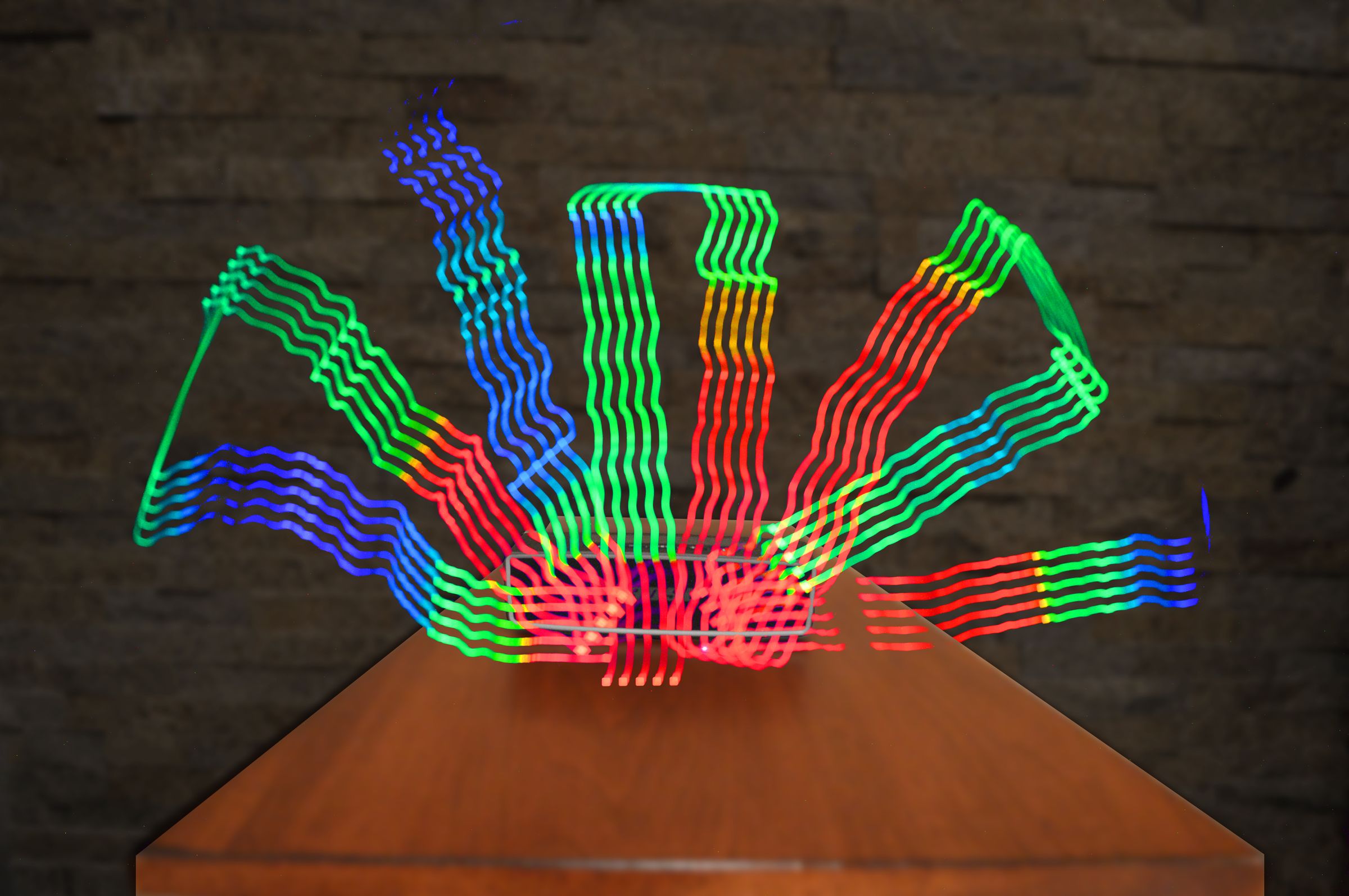

And now you have a finished image showing the strength of a Bluetooth signal around your Bluetooth device! Keep experimenting with different techniques and scenes to see what kind of images you can create.
