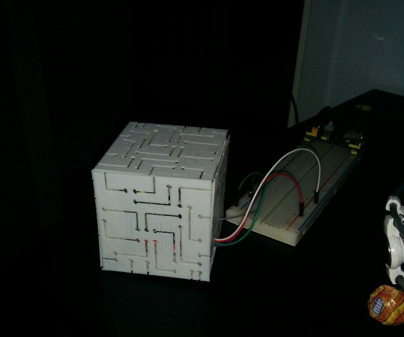

We'll be making the enclosure for our project first. I've drawn up some plans in Tinkercad and converted those to flat svg images to cut out on the laser printer.
By using Inkscape to fix the STL that Tinkercad outputs - Our FabLab uses RGB(255, 0, 0) as a cutting a color and 0.1mm line thickness - I got 3 seperate files that I used to print out the walls. Sadly I lost my original SVG files in a recent laptop crash but I've managed to retrieve the original STL files that I derived my SVG files from. They are attached to this step. Also I have the original model viewable over here: https://www.tinkercad.com/things/6dQwoG4XviE-brave...
You might have noticed a bottom and top section are missing. The parts were supposed to be included but also got lost in the laptop crash so I improvised and made the lid by hand. The downside to this is that I couldn't get my finish as good as I wanted but for a prototype it's good enough. You can notice this especially on the lid which also doesn't use an optimal hinge.
I'm using sheets of plexiglass that I cut (poorly due to time constraints) to create the windows for the display. I'm using super glue to fix them to the MDF of the case
---BIG WARNING---
Super glue (Cyanoacrylate) sticks to EVERYTHING, this includes sticking your fingers together but also ruining your plexiglass (like you might be able to see in the photos of the final product. Please be careful when using it and always use it in a ventilated room when you do since it might also react with the material your using and release vapors.
---BIG WARNING---
The bottom panel has a single hole for the 5mm WS2028B to shine through. Next up is assembling the electronics, don't worry it's simple!
