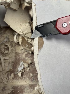

Step 2: Bevel All Edges of the Square
Using your utility knife cut at a 45 degree angle at all sides of the drywall so the compound can sit nicely.

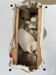

Step 3: Cut and Screw in the Wood Strips
This is to back your drywall patch piece. Cut these with an extra two inches above and below your hole. Install these vertically parallel with half of it visible and half not. Screw into place with 2-3 screws sunk below flush level but not breaking the paper.

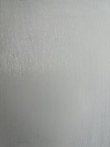

Step 7: Second Coat
This should be less than the last coat but layer this horizontally and wait for it to dry.

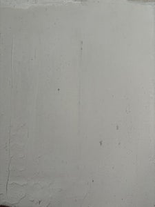

Step 8: Third Coat
After your second coat is dried install this coat vertically but with less mud then before to make a smoother finish making sure no tape is visible.

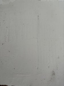

Step 9: Sanding
Once the third coat is dry, sand the mud to make it smooth and flush with the wall.
