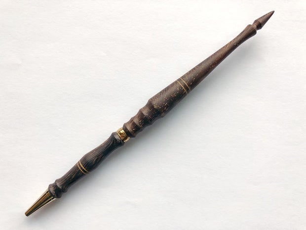

I'll take a chance to showcase some of the wand-erful pens I've made so far. The one below is purpleheart wood with chrome hardware.
Below is ebony with golden hardware and gold paste rubbed in.
This one is wenge with the same gold hardware and gold paste. I learned to use the pores to my advantage!
