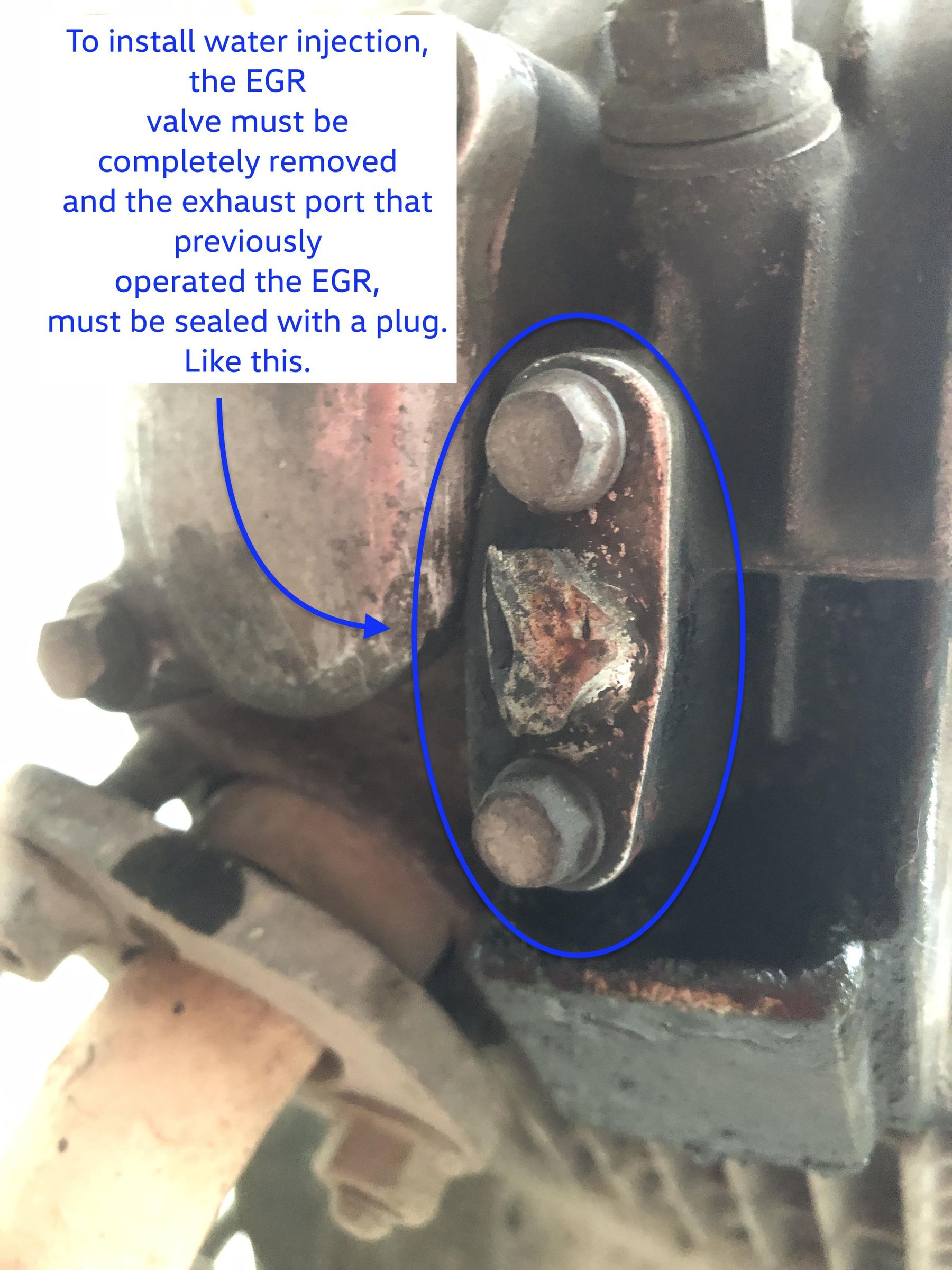

2. EGR Valve Removal: To start, you'll need to completely remove the EGR valve from its original location. The EGR valve removal is essential to make way for the water injection system. Don't worry; this procedure won't adversely affect your engine.
3. Sealing the Exhaust Port: After removing the EGR valve, you'll find the exhaust port located at the engine's head. This port must be sealed precisely to maintain a closed system with the new water injection setup.

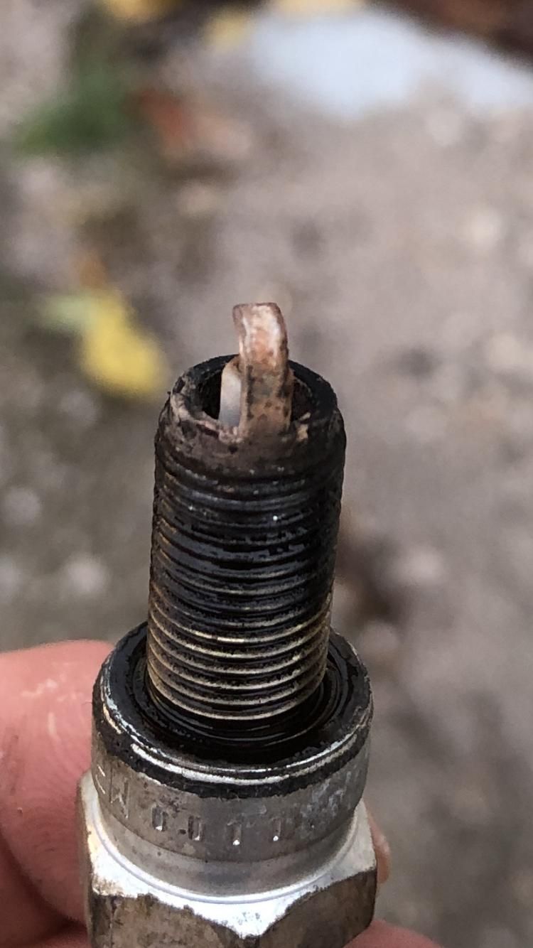

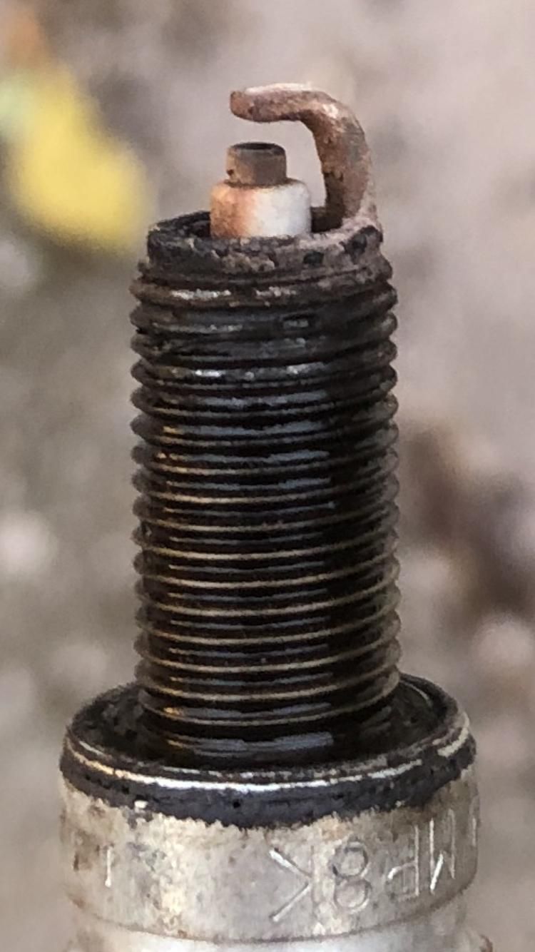

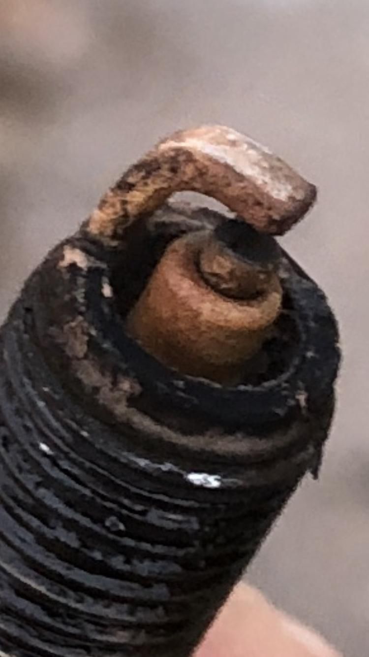

Spark:
Additionally, it is worth noting that the spark plug was changed precisely at the initiation of the water injection system and has since covered 6000 km. I have photographs depicting its current condition. The color of the spark plug's electrode clearly provides compelling evidence of impeccable combustion without deposits.
  1. Spark Pic
  2. Spark Pic
  3. Spark Pic
These assessments, coupled with the positive impact on fuel efficiency and engine performance, position the water injection system as a promising upgrade for the 2004 Honda Innova 125cc Carburetor. The author adheres to strict testing standards and explores potential enhancements for future iterations.
