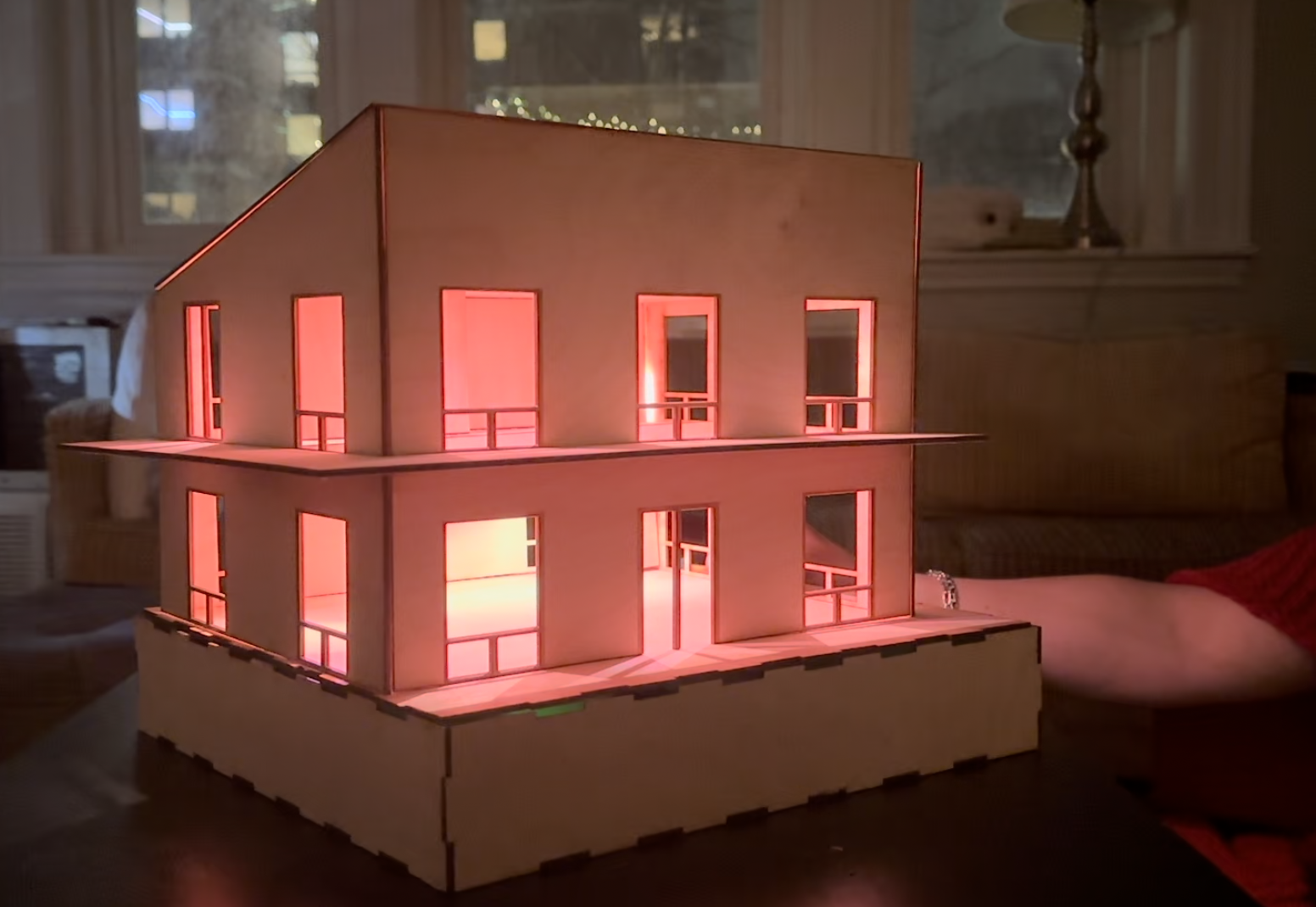

Introduction: Weather Treasure Box
Today’s build is a Treasure Box with a servo lock with a gesture password using the Adafruit Apds9960 sensor. As a bonus there is an API powered weather temperature indicator light with different colors and number of lights lit depending on the outside temperature.

Step 2: Laser Cut Files
See the attached files for the laser cutter. I used different colors of acrylic but you could also use wood- just make sure to have at least one clear piece for the mirror and lights to mount on.
Step 3: 3D Print
See attached file for the 3D printer. This print creates a ring for the Neopixel light strip to wrap around. This print took around 3 hours and 3 minutes to complete.
Step 4: Assembly
Begin assembling the box. I used superglue on the acrylic. I drilled holes for the hinges to be attached at the rear of the box. The upper chamber of the box is where all the electronic components are. For this build I had the top of the box on a sliding rail to make the electronics easily accessible if I want to make any changes in the future. You could also glue it shut if you are confident in your build. You may need to make adjustments to the servo angle in your code so that the lock mechanism works correctly. I recommend using the REPL to make fine tune adjustments.
