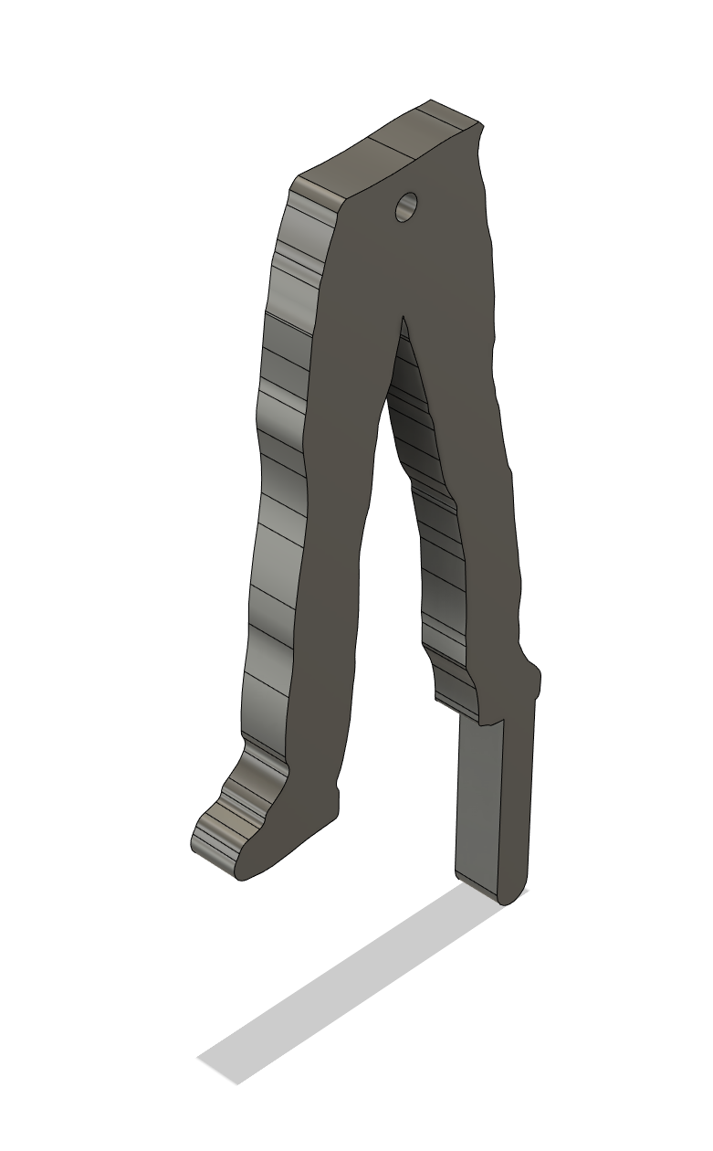

Step 3: 3D Character
I inserted the outline SVGs into CAD sketches in Fusion which allowed me to add other features to them for integration with the mechanism (cam follower, side wall). I was somewhat surprised with how seamless this step went, I was expecting more issues.

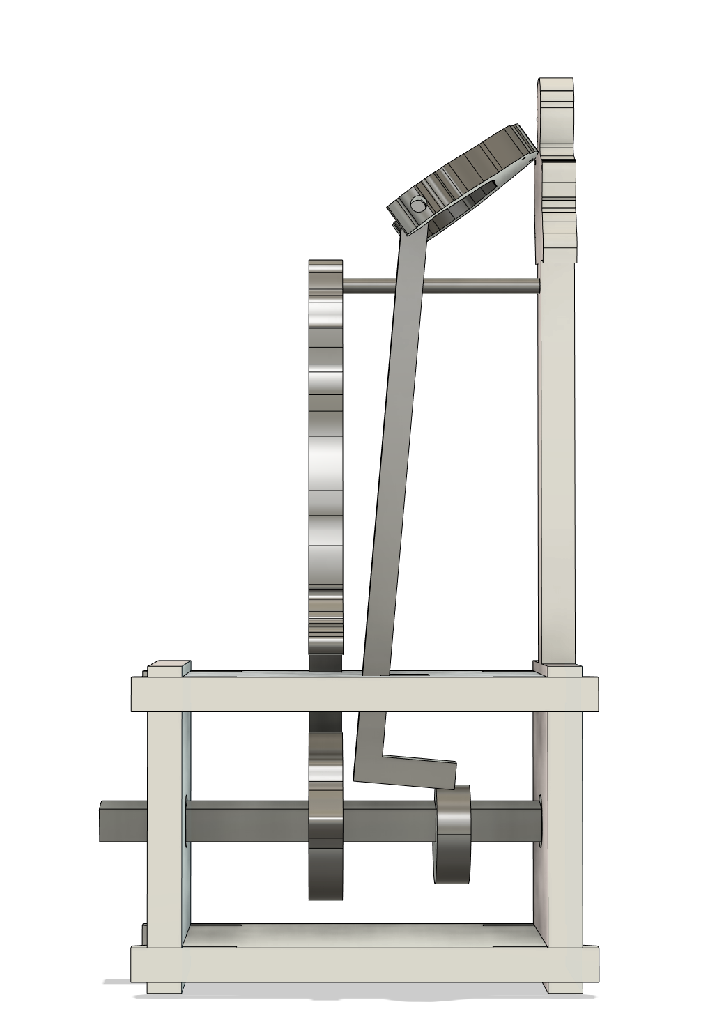

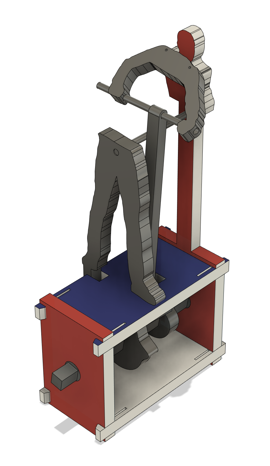

Step 4: Cam Design & Overall Assembly
To achieve my desired motions, I designed two cams. One has a gradual incline with a steep drop (for the arm motion). The other has a circle on one half, and periodic bumps on the other (for the leg oscillation).
The overall box was based on Alejandro's example box, and I adjusted it for laser cutting.
