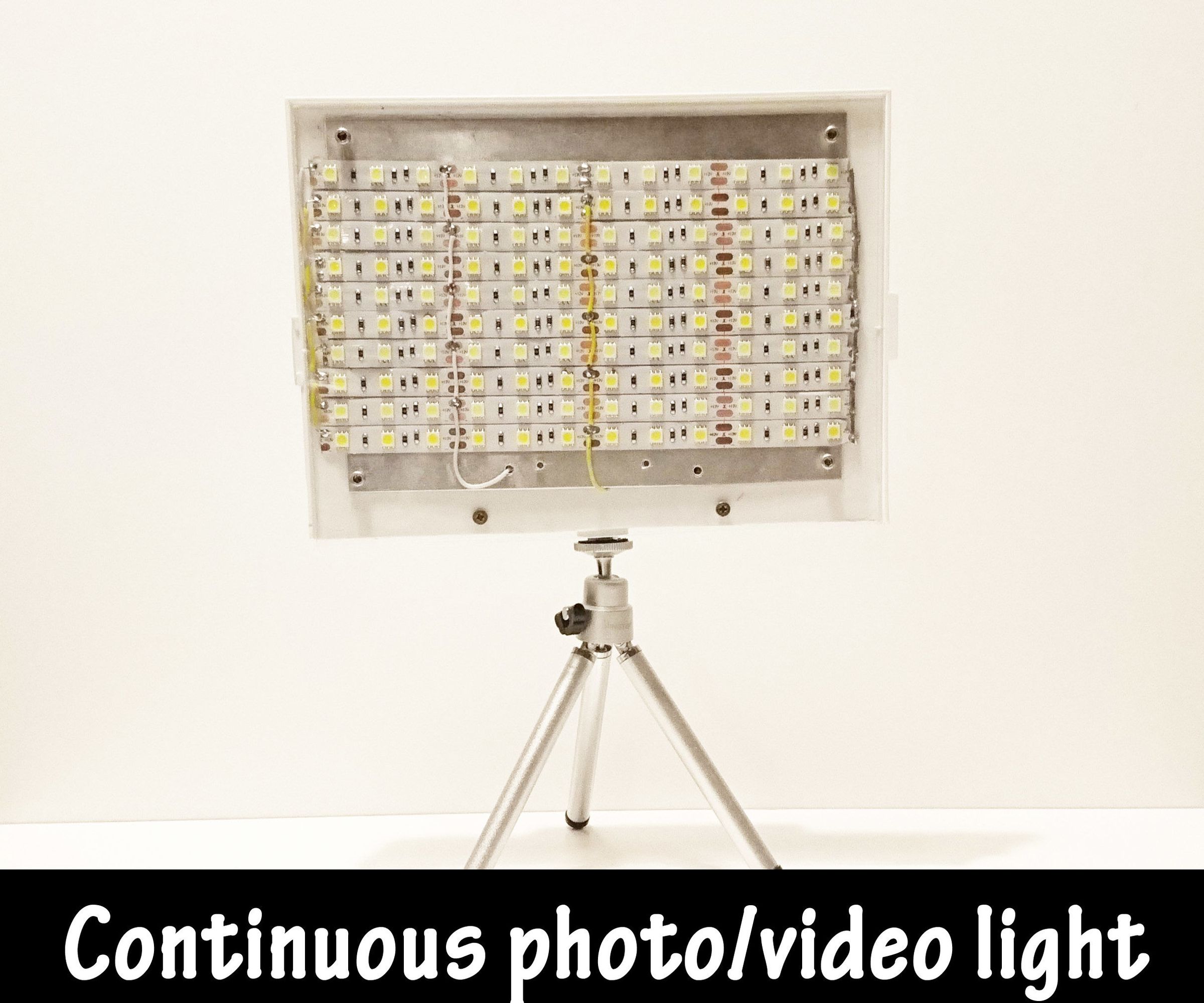

Since I decide not to multiplex the light, which on one hand means that I can turn on all the leds at once and turn this sign into a VERY bright light panel, means on the other hand that power consumption will be an issue with increasing amount of leds.
Each led is said to draw 60 milliamps (mA) on full brightness according to the eBay site I got them from. This means that if I turn the sign on to full brightness on all leds the sign will draw 0.06 * 240 = 14,4A, which is a lot! During normal use the sign won’t even be close to these kinds of power consumption but since Murphy and his law is a well-known enemy of mine I decided to calculate with worst case scenario.
Handling 14+A is not fun at all and would require way too big cables, not to mention heat problems. So to solve this power issue I realized that I’d have to portion down the power to the leds and go with many smaller drivers rather than one beefy sucker.
The total power consumption was calculated to be around 72W which there are a lot of adapters that can handle especially for laptops but then they usually run on a higher voltage than 5V. By using several mini dc-dc buck converters I could drive the whole thing from a higher voltage rather than current. Each converter could handle up to 3A and have an input range from 4,75-23V. This means that I can drive up to 50 leds. I used a total of 8 drivers for this sign where I paired them to a group of 3-4 columns of led-strips each.
This way I can feed the sign a higher voltage with less current which is easier to do than delivering 5V and 14,4A current.
