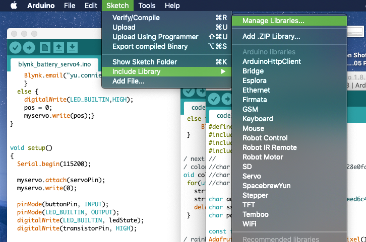

Before you can use the code, you'll need to download the libraries that the code uses (the ones at the top of the code). Read through and follow this guide from Adafruit (start at "Using Arduino IDE") for what you need to do to set up for the ESP8266. Yes: you'll need to install the CP2104 Driver, add to the Additional Board Manager URLs in Arduino preferences, install the ESP8266 package (go to Sketch > Include Library > Manage Libaries... and search up what you need -- see picture below), and also install the other libraries at the top of the code for neopixel, Blynk, etc.

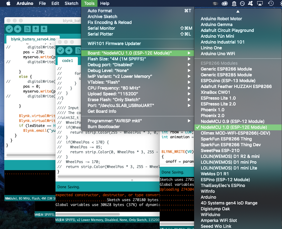

To upload code to the ESP8266 chip from the Arduino IDE, you'll need to select the correct board (NodeMCU ESP8266 ESP-12E), flash size, port, etc (see picture below). The correct port SLAB_USBtoUART won't show up unless you plug the ESP8266 to your computer. But once it's connected, and you're sure you've correctly connected your circuit in the previous step, you can go ahead and press the arrow in the upper left corner to upload your code to the board. Yes, it does take longer than your usual uploading-to-Arduino process. You'll see it compile the code slowly, then a string of orange periods .................. as it uploads (displayed in the Arduino window's bottom black part).

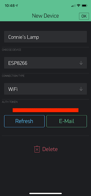

You need to add devices to the project to get authorization tokens/codes for each lamp, which you change in the Arduino code as previously mentioned. Press the Devices right arrow to create new devices. When you create a device, you'll see its token like in the picture below (blurred in red).
Once you have the code, remember to input the correct token, wifi domain, and password in the Arduino code for each lamp. You should probably input your own wifi credentials first to make sure each lamp works properly and debug as needed, but then update with your recipient's wifi domain and password before shipping it out.

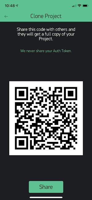

When you send the lamp to your recipient, they'll also need to download the Blynk app onto their phone from Google Play Store or Apple's App Store to control the lamp. You can either have them make a separate account or use your same login. If they make a separate account, you can share a special QR code for others to use for 1000 points (NOT the one I shared in the previous Blynk step; this QR code provides permission to use the same app as you, but they can't change any of the button settings or configuration -- read through this page, specifically "share access to your hardware"). You need to make sure you turn on the app (press the play button in the upper right corner so you see the microcontroller button instead of the nut settings button) in order for others to use the app.
I got around the 1000 points cost by giving my friend my login information so she could log into the app via my account. If you are sending these lamps to people who aren't that great with electronics (elderly folks, in general), I'd recommend spending the $2 dollars to create a shared link so they don't have access to your account and can't mess up your app settings. With this QR option (1000 point cost), they still have a clone of your app but can't change anything.

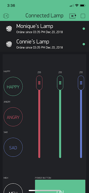

Step 8: Using the App
Now, how can you use the app to control the lamps?
Turn the lamp on and off with the big power button (red when off, green when on). If the lamp is turned off, it automatically turns off all other buttons in the app and sets RGB to 0, 0, 0. When you press to turn the lamp back on, the lamp starts with pulsing white.
There are the three RGB sliders in the top right to control the RGB color output in the lamps' flashing. They update the color real-time as you are adjusting the sliders. You can also adjust the color with the zebra shaped color map at the bottom of the app. This is connected to the RGB sliders, so the sliders update based on what color you choose in the map, and vice versa.This map is helpful if you have a shade you want in particular but don't know the appropriate RGB number values.
There are buttons on the left side of the app with preset animations for happy, angry, sad, and meh. "Happy" causes the lamp to flash through the rainbow colors, "angry" makes the lamp flash between red and yellow, "sad" makes the lamp flash through blue and sky blue, and "meh" causes the lamp to create a rotating rainbow wheel. I chose the rainbow ones for happy and meh since they're more likely to be the default, everyday animations. Whenever you press one of the preset buttons, all other buttons will be turned off (i.e. if you were on "happy" but press "angry", the happy button would automatically turn itself off after a few seconds). Do note that it will take longer switching from the happy and meh animations because the lamp has to go through the full rainbow animation before it can change animation. If you turn off any of the preset buttons, the lamp will default back to blinking whichever color the RGB sliders correspond to. If you have any of the preset animations turned on but change the RGB sliders, nothing will happen: the preset animation dominates.
Before unplugging the lamp, press the power off button in the app as a good rule of thumb. Then press power on in the app when you plug the lamp back in. Do NOT adjust the app buttons when any of the lamps aren't powered on or connected to wifi (not the end of the world, but it will mess up the lamp operation). See next step for why...
