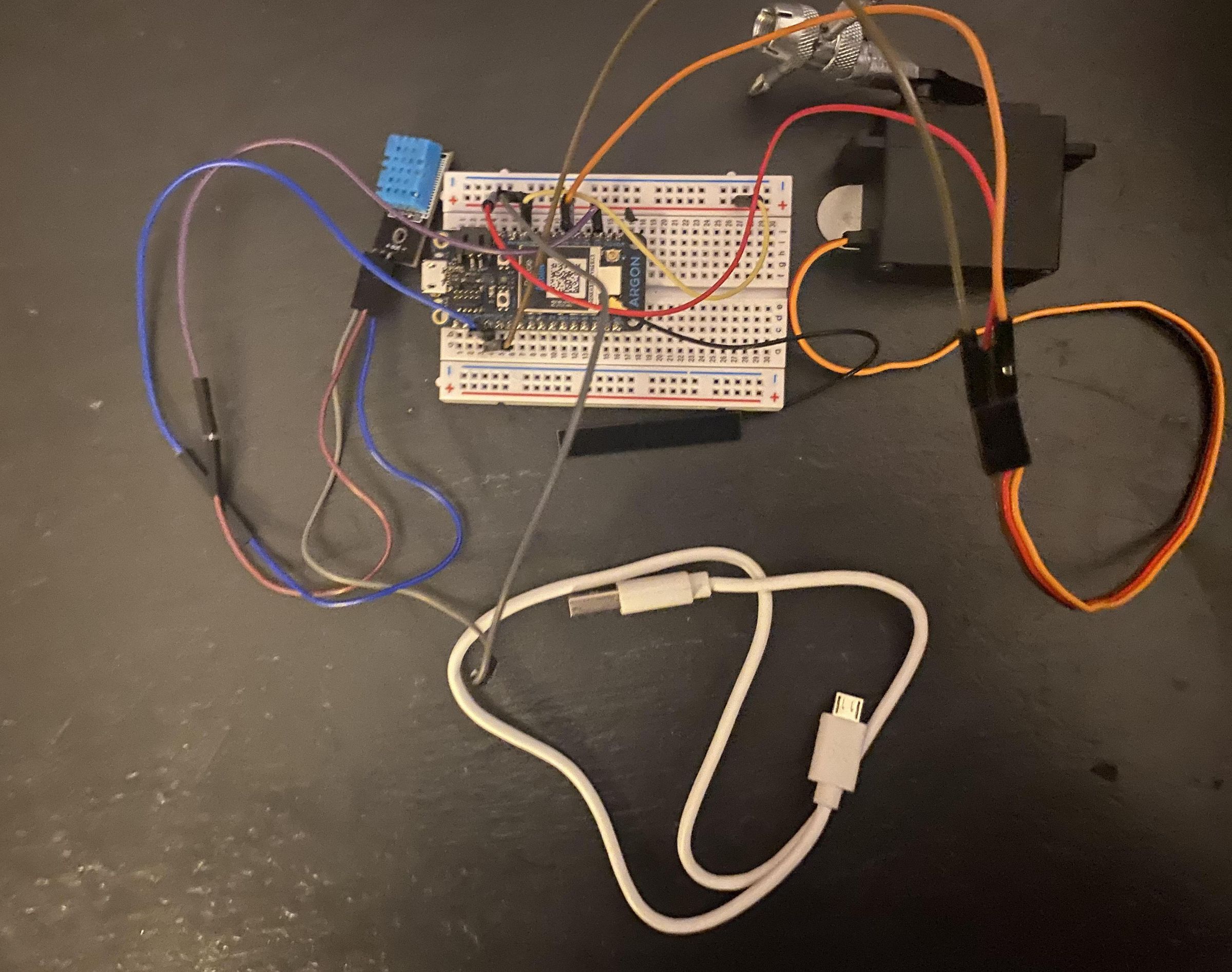

Step 1: Function
In building the project my partner and I decided to make the windows open and close. To get this effect I used one servo for each window, having them be opened at the beginning. So using the crime API from the City of Chicago database we use that to get the amount of crimes committed in a day at the beginning at 00:00:00 to the end of the day. Since the API updates information 8 days from the current date, I used the data from 9 days ago from the recent date to update my crime data too. With this I just gathered the number of crimes committed per day and from their created thresholds to affect the diorama.
Step 2: Servo Movement
After getting the data I now decided on the functions of the Servos. The intent with this project was to have the windows open up to symbolize a neighborhood free from violence, and if a windows closed to symbolize a barrier of disconnect from what is going outside. So to achieve this affect I decided to make one pair of windows close when it reached a threshold of 500 or more crimes, and if it reached a threshold of 650 or more crimes it would close the second pair of windows. The attachment of the Servos was used through arrays to better organize the code. So using this there would be 3 different outcomes, no windows closed, one pair of windows closed, or all windows closed.
Step 3: Final Setup
