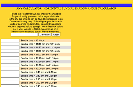

The markings on the face of the sundial are also affected by your latitude. Information regarding the angles of the hour (and other) lines can be found on the HORIZONTAL SUNDIAL SHADOW ANGLE CALCULATOR website.
I only used the hour information as the sundial is small.
I took the degree information and used Fusion 360 to draw the hour lines in accordance with the angles given.
I did a screenshot of the Fusion 360 drawing and pasted it into a graphics program to add the hour numbers and the North indicator.
