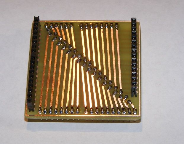

Step 1: Layout
PCB Layout, I’m sure this took longer than it should have but I did learn a lot building this simple board.
I designed this to work with the Ardunio UNO R3 board so that's why there are extra pads than normal.

Step 2: Etch
Printed the layout on transparency sheets with my laser printer.
Used a Pre-sensitized Board, and 10 min exposure with a fluorescent lamp.
Standard etching technique were used.

Step 5: Solder
Solder the male & female headers
10 pin & 8 pin for the board on the left
6 pin & 8 pin for the board on the right
