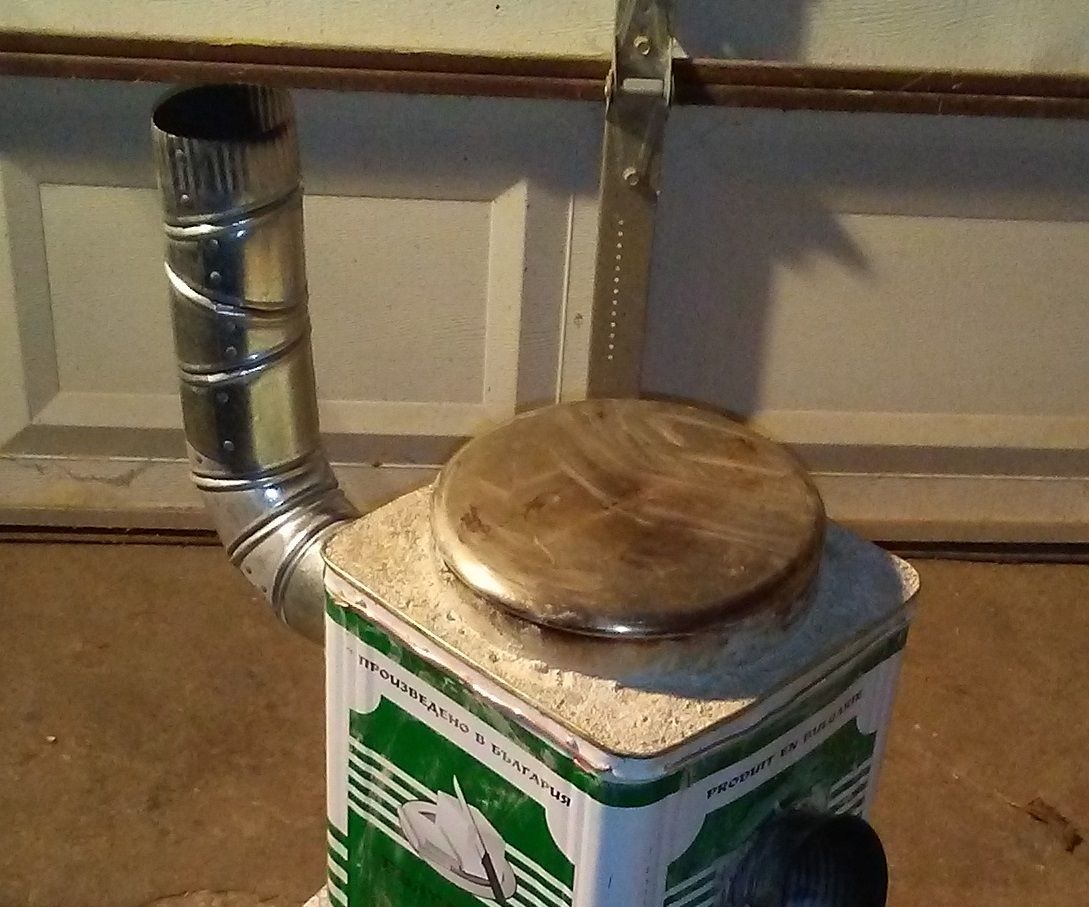

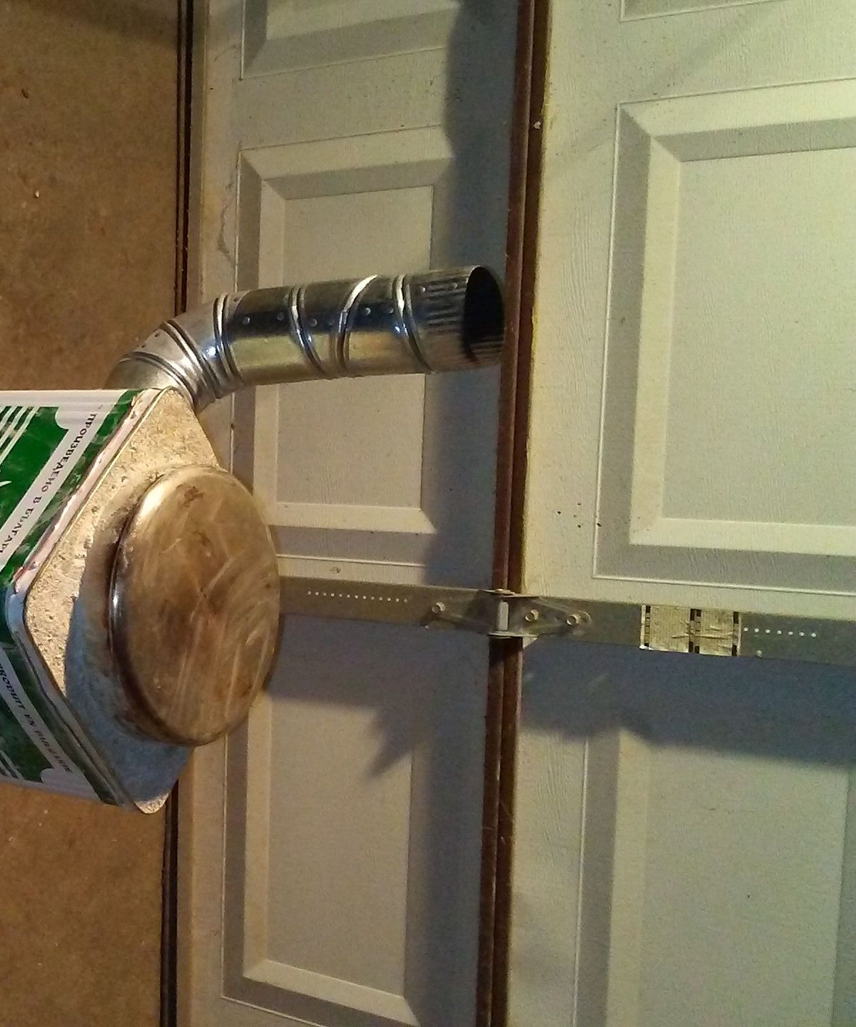

The light bulb in da brain clicked on, what if I used heat to soften the plastic. AHA I already have the heat source, my shop oven. So I tried it, worked to soften the plastic but the wires were bent, by the time i untangled a wire and attached to vise grip it was cooling off.Was working in the garage in April, a bit cold. So what now genius? Disassemble the shop oven and create wire stripping oven.
Step 3: The Wire Stripping Oven

After disassembling the shop oven I checked my lumber stash that is the picture of my garage roof. I keep my found lumber there. I found some pieces of 3/4 inch by 9 inch 36 inch plywood there.Perfect size not much cutting needed.
I cut the heating element holder in half so that it would fit in the new box. One set of elements on top and one set in the bottom, just like a toaster oven.
